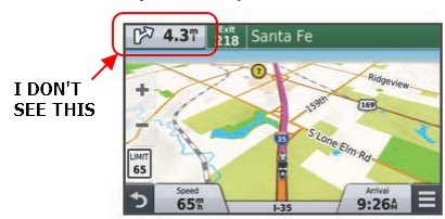

No matter what I try, I just can't get the next turn icon to appear anywhere on the map :cry:
I've updated everything to the latest versions using Express & even reset everything back to factory settings at least twice, but nothing seems to work.
I can enter a destination & allow the GPS to determine it's own route, but when I start to navigate all I see is a magenta route line on the map & white arrows at upcoming intersections... no direction information.

Try a master reset.

Thanks so much for your reply. I still dunno what the issue was, but the master reset you suggested seems to have fixed the issue. :D
