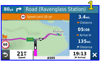

Tap the 3 dot menu in the bottom right hand corner ( you may have to close existing displays on the right by tapping the 'X' button first).
This displays other things that you can show on your screen. One of them is Trip Data.
Select this and you get a display of 3 additional items like the one that is permanently displayed on the bottom row. All positions are described as displayed in landscape view).
All four of these data items can be changed by tapping one and choosing from the list of numerous options.
There are different configurations stored depending on whether or not a trip is running, and which vehicle has been selected.
Trip Data.gif (19.38 KiB) Viewed 1311 times
In the image above the top two buttons on the right have been configured to show information relative to the next Via Point - indicated by the orange flag. The other two show data relative to the final destination - chequered flag.
This is another consideration for setting points to be Via Points.
As an aside, the display above shows a route where the next Via Point is to the left at the junction ahead, but the route has to visit the next shaping point at Ravenglass first. The data display cannot show data for Shaping points.
In this case, Ravenglass is an optional stop. I can choose to ignore it and continue towards the orange flag, and the satnav will not care because I am still on the magenta route.
This is very useful for the pillion to see the approximate distance to a next possible break as the miles count down.
Having the Via Point just after doesn't affect the milage display much, and it gives the opportunity to restart the route when fiddling with the XT in the cafe - the Via will be listed as one of the next destinations available when you select Go!

THANK YOU! I missed the fact that Trip Data fields could be customized when reviewing the manual. I also have discovered that the data displayed when tapping the speed button contains time and distance info to the next via point.
