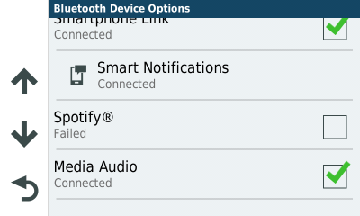

This is what I get if I connect the Android to the Zumo 595
Spotify is open and running - but it isn't making a connection to the Android phone. The box will not accept a tick. It removes it and fails.

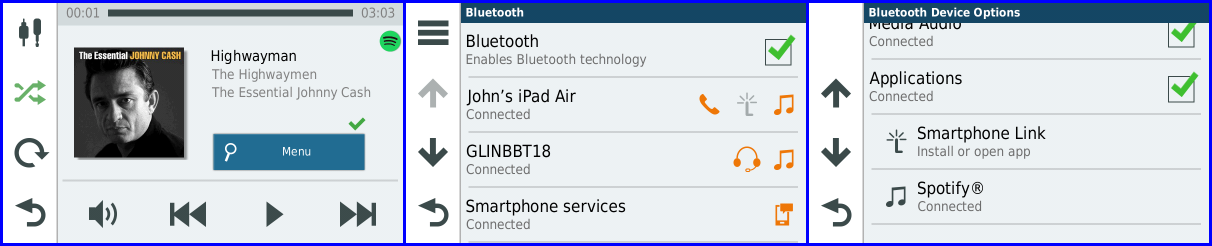

If I connect the Ipad to the 595, Spotify works OK. (Click the image for a clearer version)
Spotify - Android vs iOS 17.png (96.51 KiB) Viewed 5795 times
Screenshots, left to right.
Track playing and image obtained from spotify. The menu button has text links to my favourites, recents, Library, etc. All of the stuff gleaned from my spotify account. Click one and it starts playing that selected list.
The BT connections. It doesn't actually have a phone connected, but it has the ipad which is capable of taking a SIM card - so it thinks that there is aphone connected. GLINBBT18 is my cheapo bluetooth headset that I use for testing Zumo functions. It has some smartphone services operating - but I didn't check which.
The 'Applications' section in the last screen doesn't appear when the Android is connexted. Smartphone link has been setup, but I didn't enable it for this screen shot. And Spotify appears in this list as connected.
So it appears as though the Android Spotify App is the thing that is causing the issues, as it is working as it should with my iPad.
