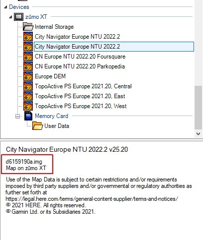

1) I have installed City Navigator Europe NTU 2022.2 maps on my Win 10 PC. For this I used my BMW Nav. 6. On the Zumo XT I used the installation with wifi. When I connect the Zumo to the PC and open Basecamp there are 3 maps, one is that installed on the PC and 2 are installed on the Zumo. Why? In the photos you can see this.

If you see the images now, is it normal to have two City Navigator Europe NTU 2022.2 maps on my XT?

Same map listed twice in Bascamp ?
One will be the one on the computer.
The other is probably the same map in the Zumo.
Also, the NTU Europe maps appear twice in the Zumo - "CN Europe NTU 2022.20 All North" and "CN Europe NTU 2022.20 All South".
In Basecamp in the left hand window, if you click on the map in Internal Storage, the name of the file and where it has been saved is shown in the bottom window.

Thank !!!jfheath wrote: Sun Apr 03, 2022 11:19 pm Same map listed twice ?
The other is probably the same map in the Zumo, because the Zumo is connected.
Is this normal? I delete the second route on the zoom every time?
Re: Two maps in the Zumo XT? And other problems incomprehensible for me
Yes it is normal. (I've just altered my previous reply to include more detail).
No - do not delete them.
If you use Basecamp, use the maps on the computer - it is faster ! Basecamp will tell you if you have chosen the map on the Zumo XT.

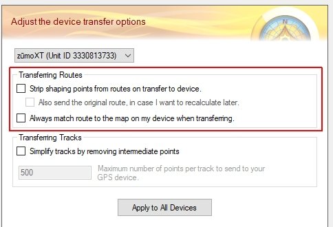

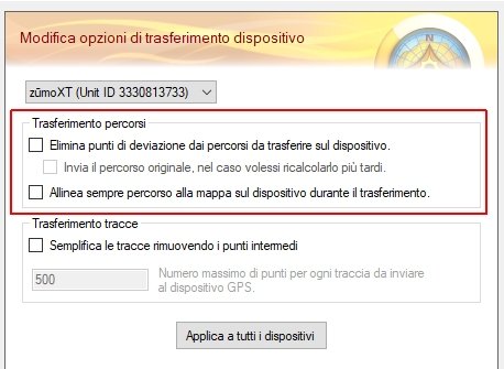

Ok @Raf - I know a number of ways that this can happen, but not in the way that your images show. I'm having a look at it now - see if I can reproduce it on my 595.
I may be some time ......
Can you post a copy of the gpx file please ? Send a PM if you wish.
Also - please check -
ITA: Modifica -> Opzioni -> Trasferimento dispositivo
UK: Edit -> Options -> Device Transfer
The three boxes are NOT ticked.
