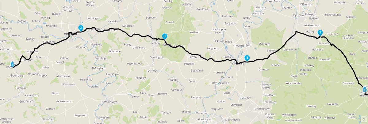

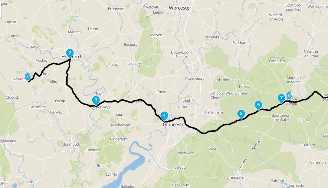

I had the points in MRA set to both Via and Shaping points depending whether I needed to stop at particular places. I guess I need more shaping points to force the XT to take the route I want and not just what it wants.
This is the route I had wanted to take;- This is the route it took me;- When I got to point 8 I gave up trying to follow my route and navigated by memory instead as it seemed to be taking entirely arbitrary routes. So I still don't know why it took a different route.

If you want to post or send me a pm with the gpx file - or share the MRA route (not that I have ever done that yet) - I will take a look.
The XT does seem to go a long way out of its way if there is a main road nearby - regardless of whether that results in a faster time. And around there you have the M4. Your shaping points may need to be placed with that in mind.

I exported it from MRA using Garmin Zumo XT gpx1.2. The XT imported into the trip planner and I started the route from there. When I got to Hereford it was there that it took me towards Ross on Wye rather than towards Tewkesbury as I had intended. When I got to the M50 it wanted me to take that and then rerouted me via Newent and Gloucester. Once I eventually got to Stow I skipped the planned tea stop and it then went haywire. I then took the A436 to Chipping Norton and since it wanted to take me up to Banbury and then probably via Northampton and the A4 I took the road I know through Aynho and to the A421. When I got there it wanted me to go up the A43 so I ignored it.
