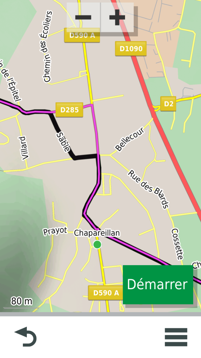

Hello everyone, I just bought an xt juice. I have a problem, to see if someone can help me.
The thing is that when you see a track on the map, and put the route of that track, the route is superimposed on top of the track, preventing its visibility.
On my old 595 it was upside down, so I could see my route and my track at the same time. Does anyone know if this is possible on the XT?

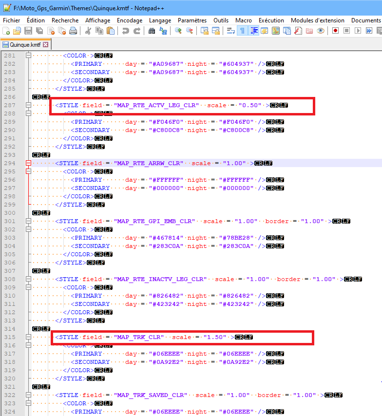

Hello,
To view both the route and the track,
you must also modify the lines of the xxx.KMTF file
like this

quinque wrote: Tue Feb 08, 2022 4:54 pm Hello,
like this
do you do it with javawa?

Hello,
I used the text editor "Notepad++"
(see the tutorials on modifying .KMTF files)
