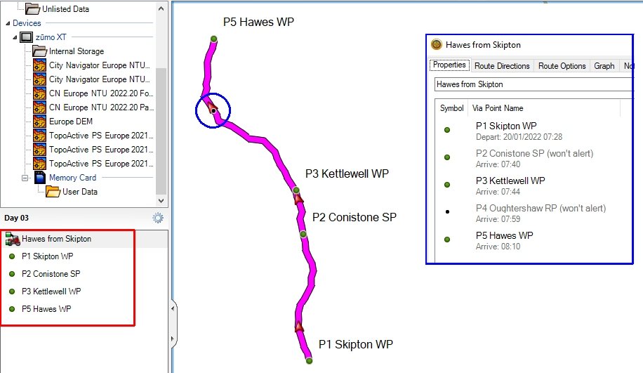

Questions Answered Part 1 - Basecamp Route.
One route on a Basecamp screen. Including the start and the finish there are : 5 route points. 4 Waypoints. 3 Via Points, 2 Shaping Points.
Note the clues - the blue circled point and the highlighted red box and the Route Properties.
Can you work out which is which ?? What is the issue with P4 ??

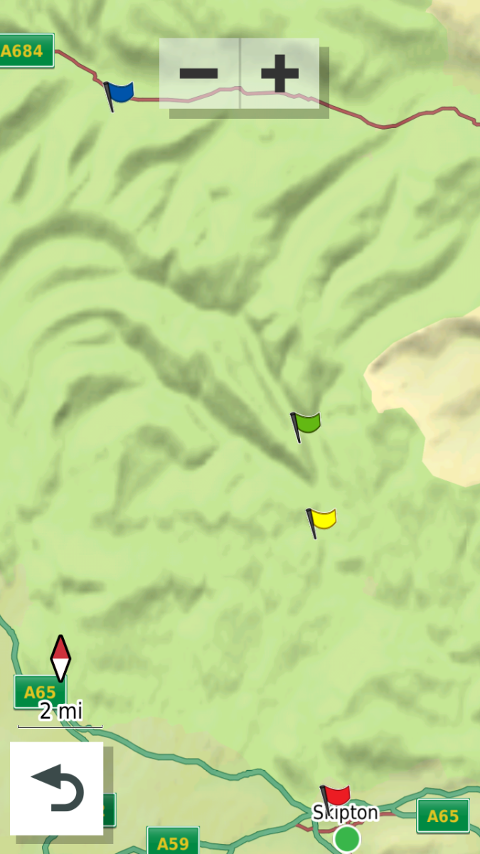

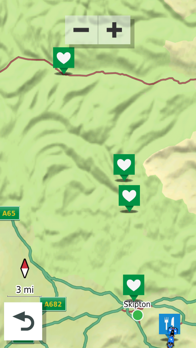

Question Answered Part 2 - Waypoints shown on the XT screen.
These two screens show the same thing - the zoomed out map with just the Favourites showing. At this point, the route has not been loaded, but they Waypoints are stored in Favourites automatically if the route is transferred to Internal Storage. You do not need to import favourites unless you transfer routes to the SD card, or they have been transferred without being part of a route. Waypoints mark places on a map that are not necessarily part of a route.
This map shows the Garmin Explore stye waypoints. They default to small green flags. I have selected different colours for each of them.
I emptied the Zumo of other favourites before getting this screen shot. These are only the waypoints that were sent with the route.
This shows the same thing, except the Garmin Explore link has been disabled. Instead, much larger icons can be turned on in 'Up Ahead Places', Favourites default to showing up as hearts, but the icon can be changed. Not very pretty. I dont turn this feature on as in this case it also turns on 3 other categories - hence the restaurant icon..

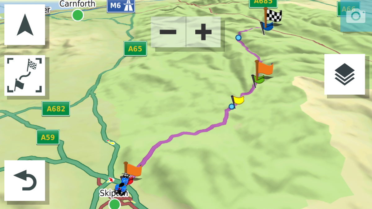

Re: why did garmin start taking me back home
Questions Answered Part 3 - XT Route Map and Symbols.
Here is the full route showing the magenta line, the waypoint flags and the Via and the route point symbols. There are 5 route points, starting with P1 at the bottom where the bike is shown, and P5 at the top where the chequered flag is.
Large Orange flag is the start of the route (P1)
Large Chequered flag is the end (P5)
Large Orange flags are the announcing Via Points. (P3)
Small blue discs are the non-announcing Shaping Points. (P2 and P4)
The user has no control over how these appear on the map.
The waypoint symbols are suprimposed on these - so route points that were first created as Waypoints will be marked with two symbols)
Note in particular the P4 shaping point shown as a small blue disc - the one that was created with the insert tool.
Also the blue disc at P2 - which has a small yellow flag. This was created as a Waypoint, but made to not announce - so it is a shaping point with a flag.
P3 has the orange flag to indicate a Via Point, and also a green flag in this example indicating a Saved location - ie a Waypoint.
Waypoints / Saved Locations / Favourites (they are all the same thing) can have different symbols assigned and, as in this case, there are options to choose the same symbol in different colours. Groups of Waypoints can be made and placed in one or more collections. Collections can be turned on and off, so that you have full control over which ones are displayed on the map.
It is not possible to change the orange flag and blue disc icons that are used to represent Via Points and Shaping Point on the route.
Much more about this can be found in Zumo XT and Basecamp - Everything you need to know
The link to the pages relating to the above is here: app.php/ZXT-P66
