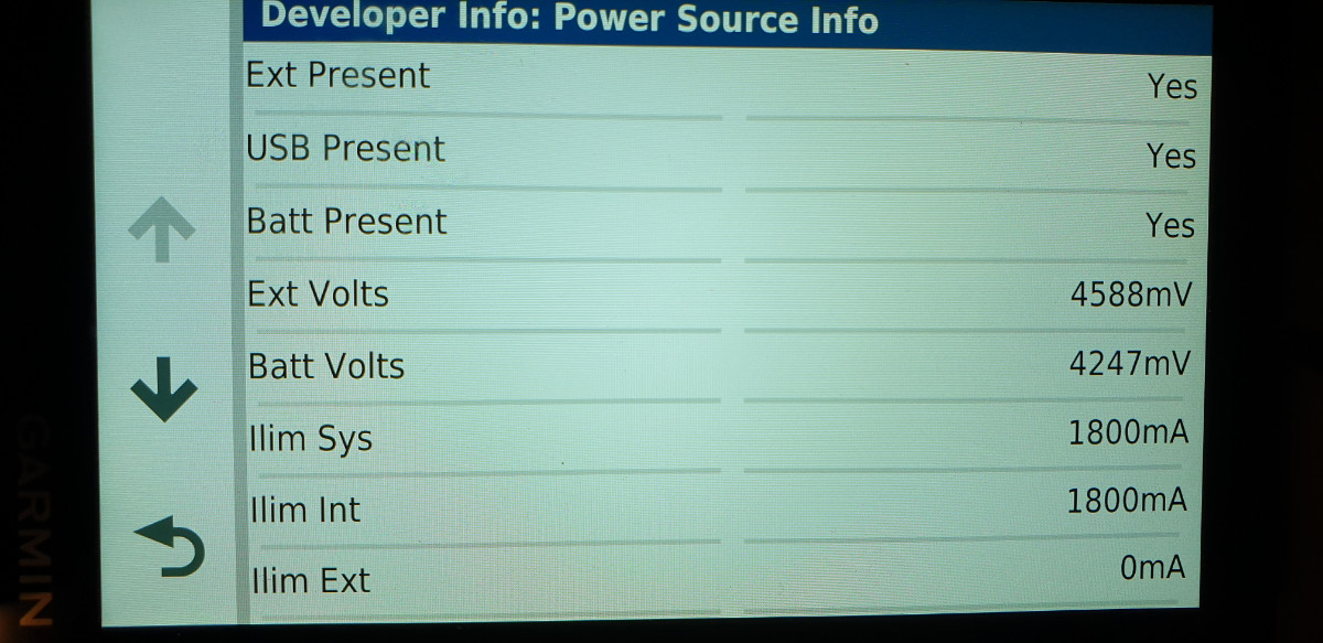

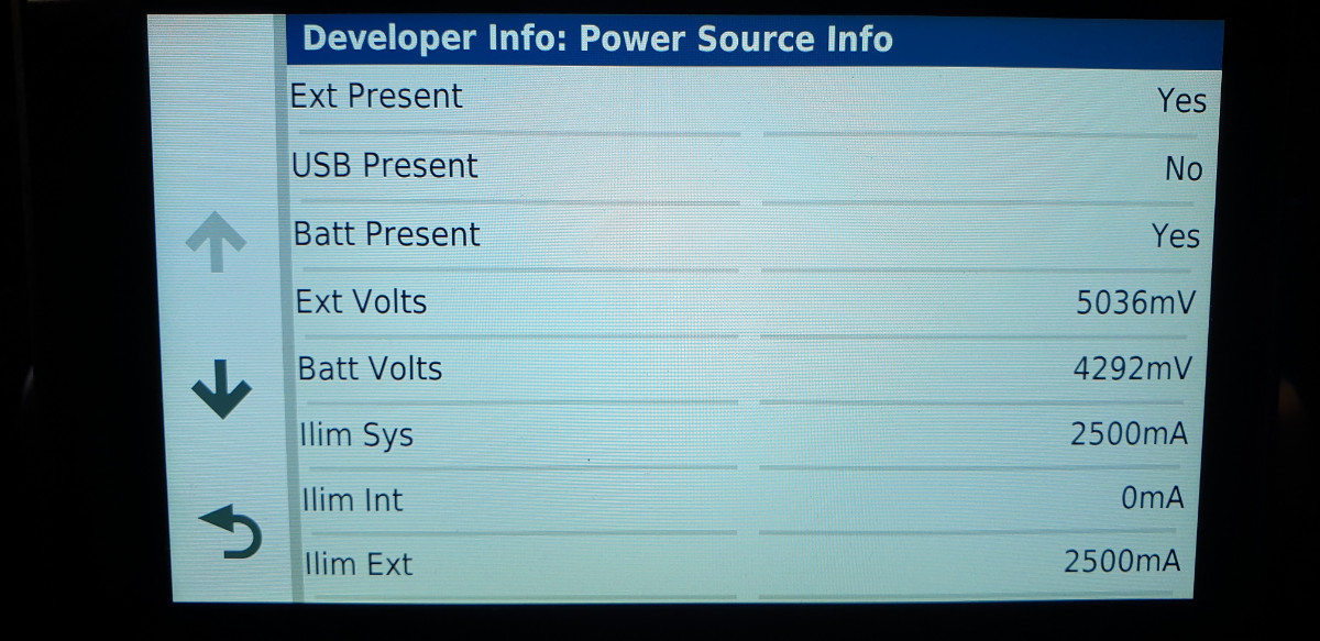

Please beware that most USB chargers dont provide enough power/volts for fast charging. If you have the XT mounted on the bike with the original cable it gets charged with more than 5 Volts. That is the fastest charging i know. About 1 hour of driving.
Look for 'Developer Info: Power Source' and compare 'Ext Volts' and Batt Volts
Voltage when mounted on the bike:
Voltage on bike.jpg (283.52 KiB) Viewed 2890 times
Voltage when connected to USB charger
Voltage on USB.jpg (222.52 KiB) Viewed 2890 times
Note: Batt Volts > 4250 mV I consider it fully charged
