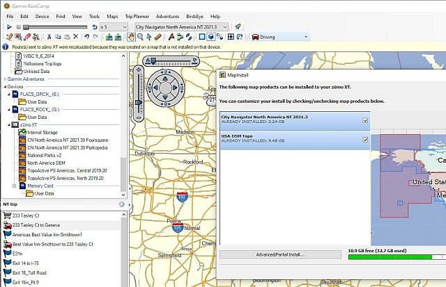

I'm still getting "there was a problem connecting with the Zumo" errors, but it does connect and I can transfer routes to it. But some things that I don't understand cropped up:
1. Although I have identical maps on the Zumo, and Basecamp, it says I don't and re-calculates when I send a route to Internal Storage.
(see attached jpg,showing the error, and Map Install verifying that I have identical maps. (and I have that map checked in the Zumo) .
2. When checking the routes on Zumo, (which defaults to Motorcycle mode when unplugged), some of the routes come up bad - wrong trip distance & time, route off road (straight lines), etc. But I found that if I switch the Zumo to Auto mode in the Trip Planner, it will recalculate and then the route looks good in preview. So I guess this isn't a problem, but hope this might help someone else.
I would appreciate anyone's thoughts on this, thank you...

Before transferring you need to (a) set both Basecamp and XT to the same profile, be it Motorcycle or Driving, and (b) in Basecamp, untick all the boxes in Edit/Options/Device Transfer.
