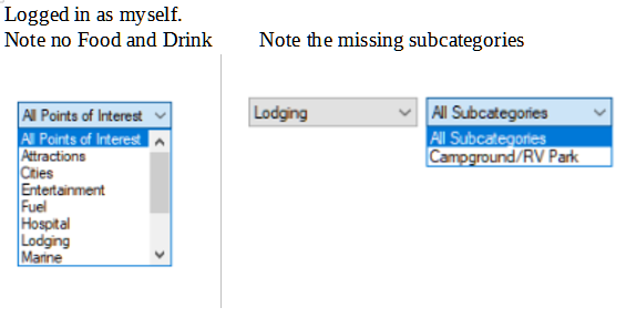

In my BaseCamp 4.7.3 I just started to created a new route and noticed that when doing a search (Ctrl+Alt+F) the categories and subcategories are much different than they used to be. For instance, there isn't a category for food any more and categories like lodging and fuel used to contain several subcategories but now the lodging category only contains subcategories of All and Campground/RV while the Fuel category only shows All and Auto Fuel. Gone are subcategories like hotel/motel and bed & breakfast. What controls this? I looked through the Options and the only thing I saw that I though might be relevant is the Map Display Features which are all enabled in the active profile (Motorcycling).

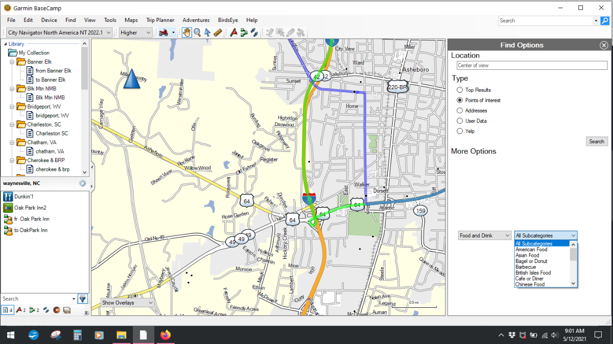

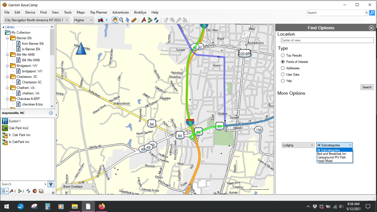

What I see with Base Camp 4.7.3 on a Win10 laptop and no gps connected:
and
Wonder what changed in yours.
and

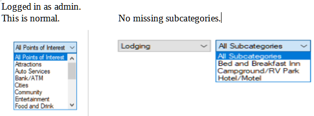

I have just discovered that my POI problem only exists when I am the logged-in computer user. When I run Basecamp logged in as ADMIN the POI subcategories are available. I elevated by user level to administration but the problem of the missing subcategories remains. Logically, the problem is be associated with the user data stored by Basecamp for user me. Does that give anyone a clue about how to fix?

Here are some screen snips of what I am seeing when logged in as myself vs. as admin. Same map is selected in each although map selections doesn't make a difference. Behavior is the same regardless of the map. The device is not connected.
