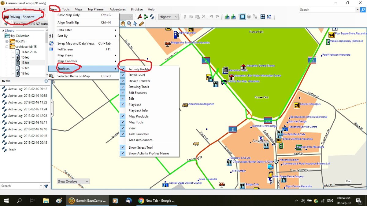

yes but when you are planning a route in basecamp at the top you have an "activity profile".Note that mine is "driving shortest".If you cant see that activity profile click on view/toolbars and make sure activity profiles is ticked.If yours is set to direct that may be the reason you are getting straight lines
