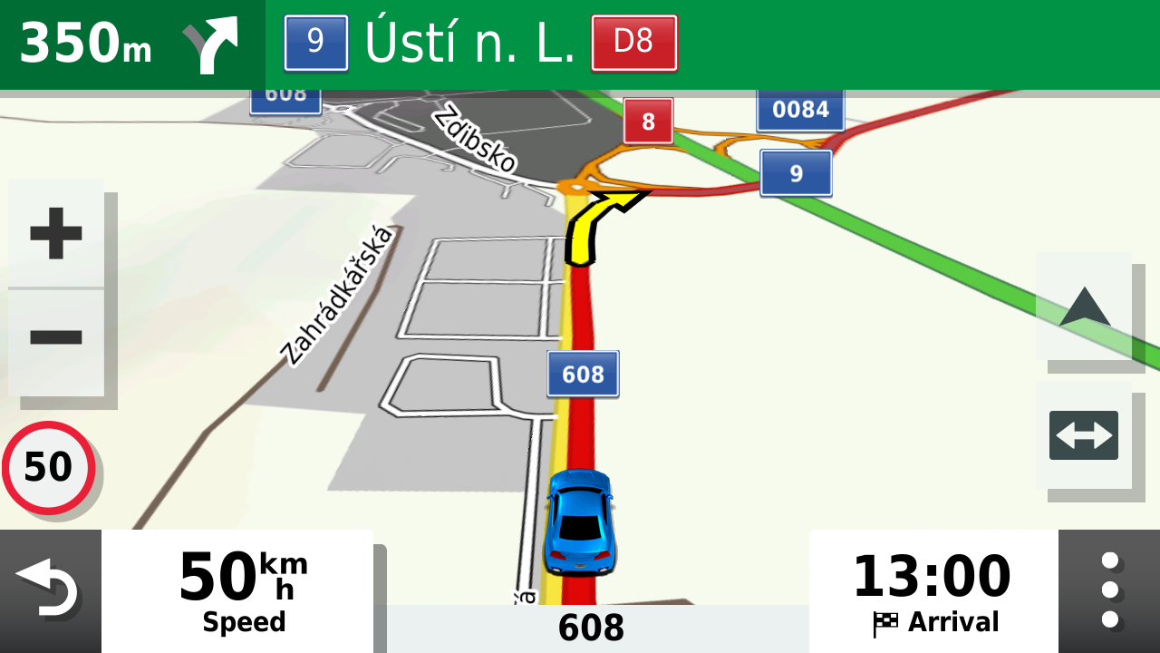

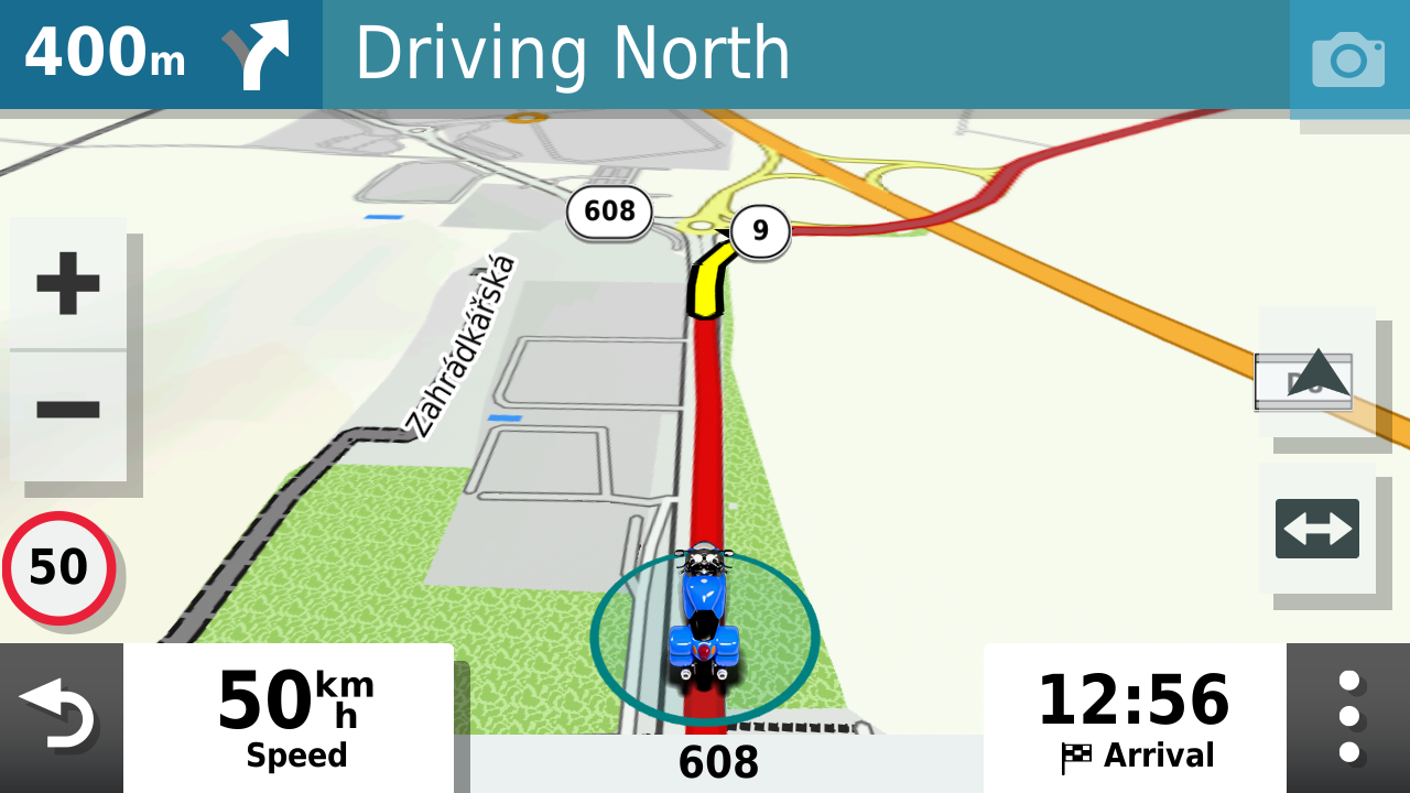

For the example here are screenshots, in both modes (Motorcycle and Car) is the same Theme, with the same colors.
In the Motorcycle mode Garmin ignore my colors and use some own default.

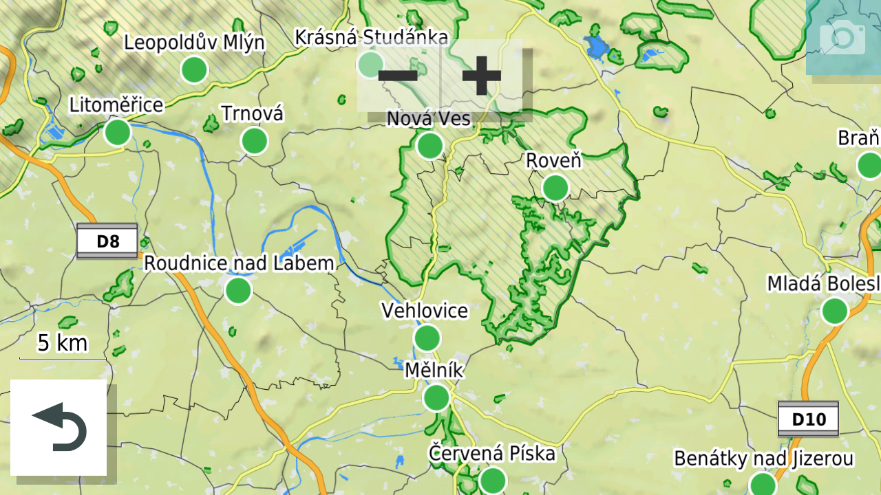

Solved.
I had turned on the topo-map in the motorcycle profile. Colors are OK after turn off topo map.
