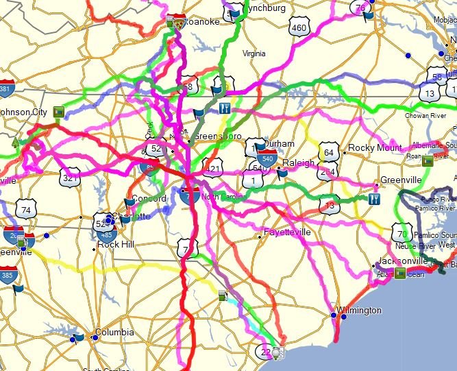

I do the first way if there's lots of routes I want to upload. The second if there's only a few.
