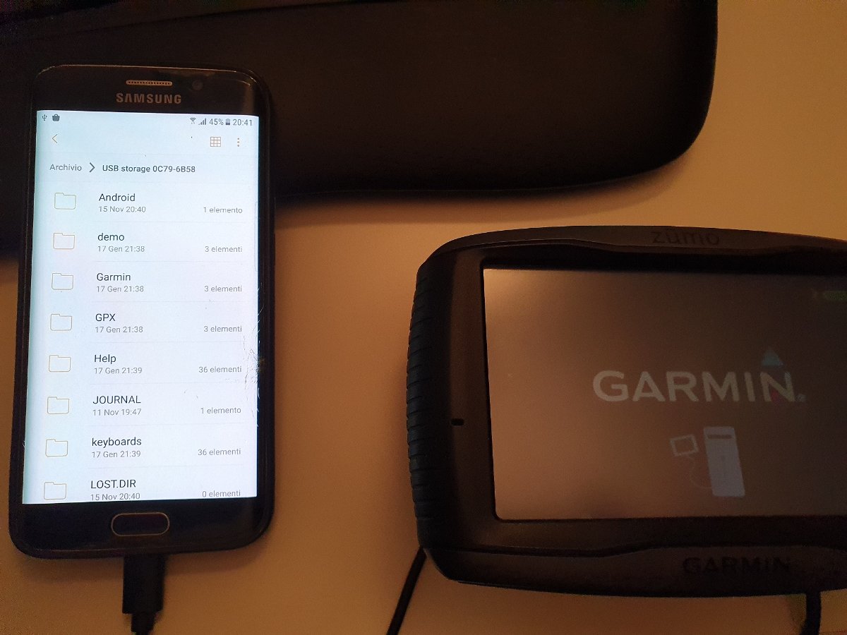

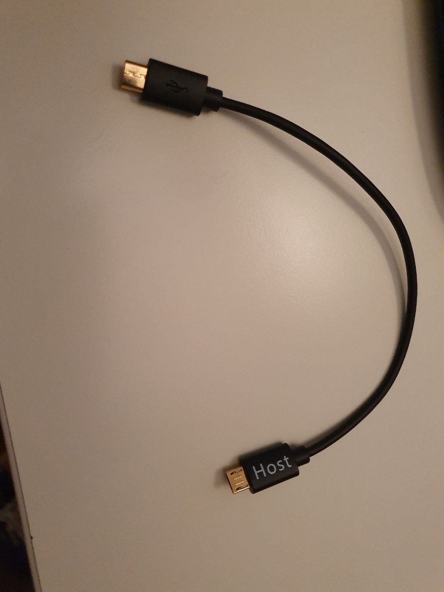

if you want share a gpx from your phone to Zumo, for now, you must use a OTG cable usb. With SMARTPHONE LINK old version is possible share a gpx with Zumo (for 595 firmware 4.5 or 4.6) but with update, for now, is possible only by OTG cable or micro sd card reader for phone (cable is more simple, just connect)
