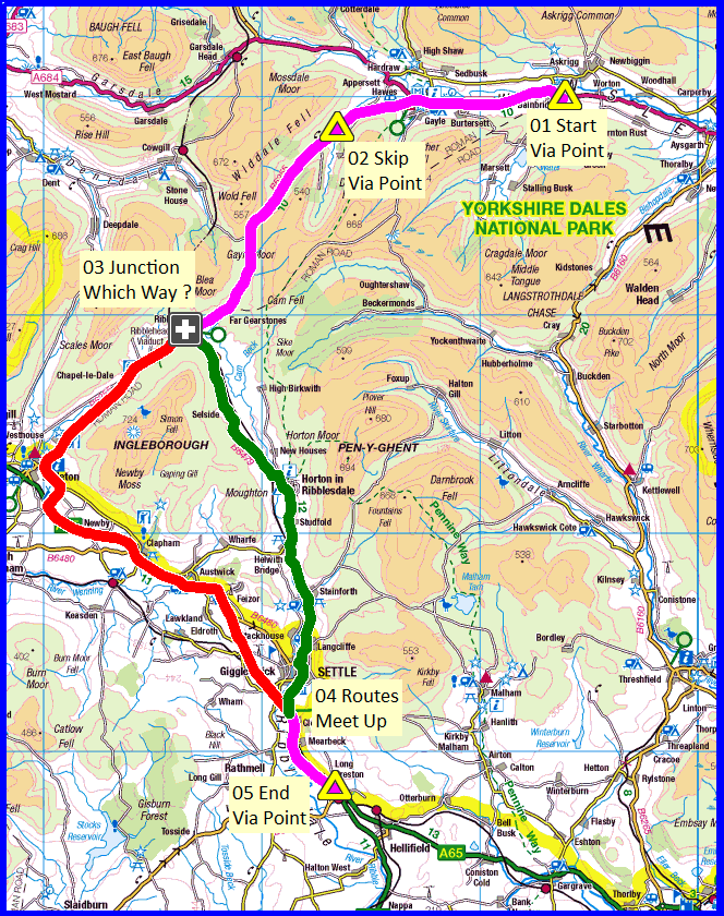

Re: Is this RUT?
Ok Sean
See the map. Click on it to get a better view.
Note that there are three via points. 01 the start. 05 the end. 02 an additional Via point that is plotted soon after 01 on the road that the route was following anyway. It makes absolutely no differce to the route whether it is there or not.
As soon as I enter the road on which Point 02 is plotted, I am going to Skip it. This forces the Zumo to recacluate the entire route. This is why it is there. It is a quick way to force the Zumo to recalculate the current route.
Later on the route itself has two options - with no roads that link them. I can look at the preview map to see which way the Zumo prefers. Whichever it is, I am going to take the other one.
So on my map it has calculated the red route. I am going to take the green.
It really does help if their is not much difference in time between the two alternatives. In this case the green route is 12.7 miles, the red route is 17 miles. But in terms of fastest - Basecamp calculates the green as faster. THe Zumo calculates the red as faster. In fact there is only a minute between the two calculations.
THis is very handy becasue as soon as I have traveled half 30 seconds down my green route, it is faster to carry on that way than it is to turn back. I give it 3 minutes. If the Zumo is still asking me to go back, I am pretty certain I am stuck in a RUT, and it will continue demanding U turns to go back to point 03 - first aid box - until I am less than a mile from point 04 where the two routes meet up again.
Another way of getting a similar result is to find a rectangle of roads with no roads joining them. I have one between the A1 and the A19 bounded northe and south by the M62 and the A65. All very major roads. There are plenty of country lanes going across, but the XT2 will not look at those. Put your start point well before one corner of the rectangle and an extra Via point so that you can skip it. Put then end point after where the roads meet diagonally opposite.
You will never get a RUT situation if you build the route on the XT itself. It only happens if the route has been create on another route planning app. Eg BAsecamp, MyRouteApp, Kurviger etc. If you have sent it to the Zumo by cable, by phone, by drive, or as a gpx file on the SD card or internal storage - those are the routes that are likely to be affected by the RUT issue.
But there are a number of fixes. One is Javascript solution. Another is to Load the imported route and then save the active route. That method adds an additional route point - where you are - at the satrt of the route. But you just slect the original start when you load the resaved version. Both routes then behave as if they were built on the XT itself. Perfectly.
Finally - I have used an Open Source 1:250,000 OS map. I can do this legally providing that I say :
Contains OS data © Crown copyright and database right 2021

Re: Is this RUT?
@jfheath
Thanks' jf. Once again, a top-notch detailed reply to my questions!
Hopefully tomorrow I will be able to set up a scenario along the lines you have advised.
I will definitely get back to this thread and let you know how it went.

That is perfectly normal behaviour if you placed a Via Point at the ice cream place. Via Points have to be regarded as locations that you will definitiely pass through. If you had placed a shaping point there - it would certainly ask you to turn off to get to the shaping point. As I understand it - when you passed the junction - you were still on the magenta line (you said you retraced your steps) that being the case and with only a shping point missed - All zumos from the 595 (and 39x series) upwards would continue to navigate ahead.gwilki wrote: Mon Jul 01, 2024 12:30 am I designed a route in Basecamp. (So, I can't ask Garmin for help.) It is a simple loop, except there is one leg where I leave the loop for an ice cream break, then retrace that leg back to the loop and continue on my merry way. Today, the ice cream leg was closed off. So, I simply kept riding the loop. HUGE MISTAKE. The XT2 started by telling me to make a uturn in 3km. Now, if it thought that I needed to make a uturn, why would I get further away by 3km to make it? I ignored the instruction. After I passed the 3km mark, the XT2 said to make a uturn in 850 metres. Same question. I ignored that one, too. This went on for about 5km, at which time, the XT2 actually started navigating again.
It seems that the XT2 is incapable of re-calculating a route when I deviate from it. I have an old Nuvi that has no problem with this task at all.
In such cases - I often plot optional coffess stops - just in case (rain, wind, comfort breaks). I mark them with a shaping point. I may put a via point (created as a waypoint) ahead of it so that I get an alert "Approaching Optional Coffee Stop in one mile on the left". I always put a Via Point on the road that I will be riding whether I visit the coffee stop or not - Coffee Stop Exit. That way if I accidentally stop the route while the satnav is in my pocket, I can start it again. When you say go!, the satnav gives a list of the Via Points. So I select Coffee Stop Exit and it will get me there no matter which way I go.
You will never stop it from telling you to U turn - if that is the best way to go, and you have missed a Via Point. The only way of it not asking you to go back to a missed Via Point is to skip the via point. But skipping a Via point is dangerous. The entire route is recalculated and the XT behaves very differently after that - including getting trapped in a RUT loop if you deviate from its route. I haven't fully tested the XT2 - but that situations has certainly been the same on my favourite test route for RUT behaviour.gwilki wrote: Mon Jul 01, 2024 12:30 am Is there some way to convince the Zumo to stop telling me to make uturns and to simply navigate to the next point on the route? If not, can someone please tell me the best accelerant to use to burn this damn thing?
Thanks much.
Grant
Answers. Dont use Via Points unless you intend to visit them.
If you have to SKip a Via Point - beware that odd things will happen if later on you have to deviate from the route. Stopping, restarting the route and select closest entry point is a good emergency solution. But check the preview map before saying go.
But here is a very nice cure-all. It doesn't happen if the route is buit entirely on the XT or XT2. You still have to be aware that you MUST go through each of your Via Points.
And the XT2 has a superb copy facility. Import your route. Select it so you get the preview map. Click the spanner. Scroll daon and select Copy.
This gives you an identical copy of the original route. Name it the same but with a code that you can recognise it as copied (beware putting it at the end of a long name, 'cos you will not be able to see it) . Run that.
The XT2 is fooled to believe that the copy has been built on the XT2 itself !
That will NEVER display RUT behaviour in the same situatiosn where the original route did display RUT behaviour.
