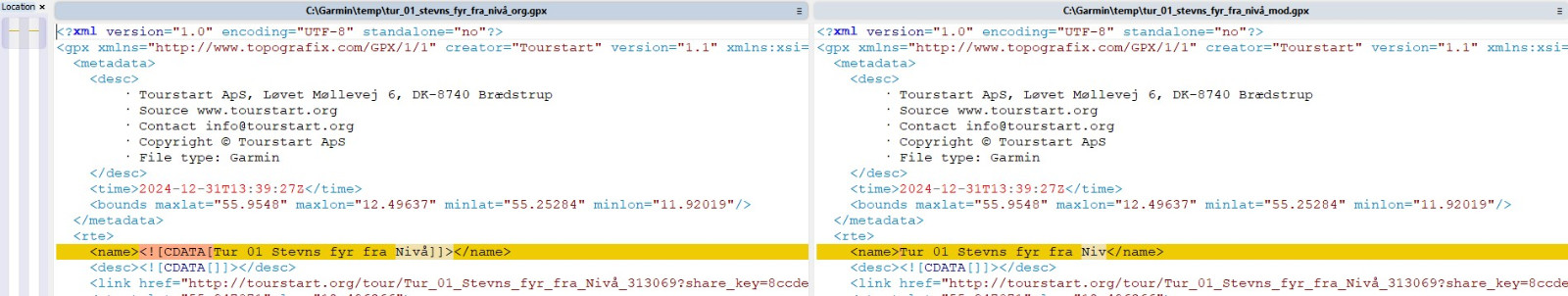

Seems like only GPX files exported from BC will work correctly, is that a correct assumption?
I have a planning tool (TourStart), and when I export a route to GPX, then send it to the XT with TripManager will all look correct with the .trip file, but does not show in the Trip Planner.
If I import the same file to the SD card on the XT, and then export it from BC, then send it to the XT with Tripmanager, then will the file show up in the XT Trip Planner.
I have attached a file exported from TourStart that have this issue, exported as route.
Brgds. Harry

HarryMJ wrote: Sat Feb 08, 2025 10:26 am Seems like only GPX files exported from BC will work correctly, is that a correct assumption?
No, GPX files from other planners should work. Provided they meet some basic standards. The truth is that I have only tested BC and MRA V1.1
HarryMJ wrote: Sat Feb 08, 2025 10:26 am I have attached a file exported from TourStart that have this issue, exported as route.
I had a look at the GPX (Thanks for that) and I can see what's bothering TripManager. The Name of the trip is in the !CDATA format. When I change that to 'normal characters' it loads just fine.
This is what I changed:
I will see if I can change the program to accept also that format. Maybe you can check if there is a setting in TourStart to get only 'normal characters''?
(maybe it's enough to replace the last character. The a with a little circle on top)

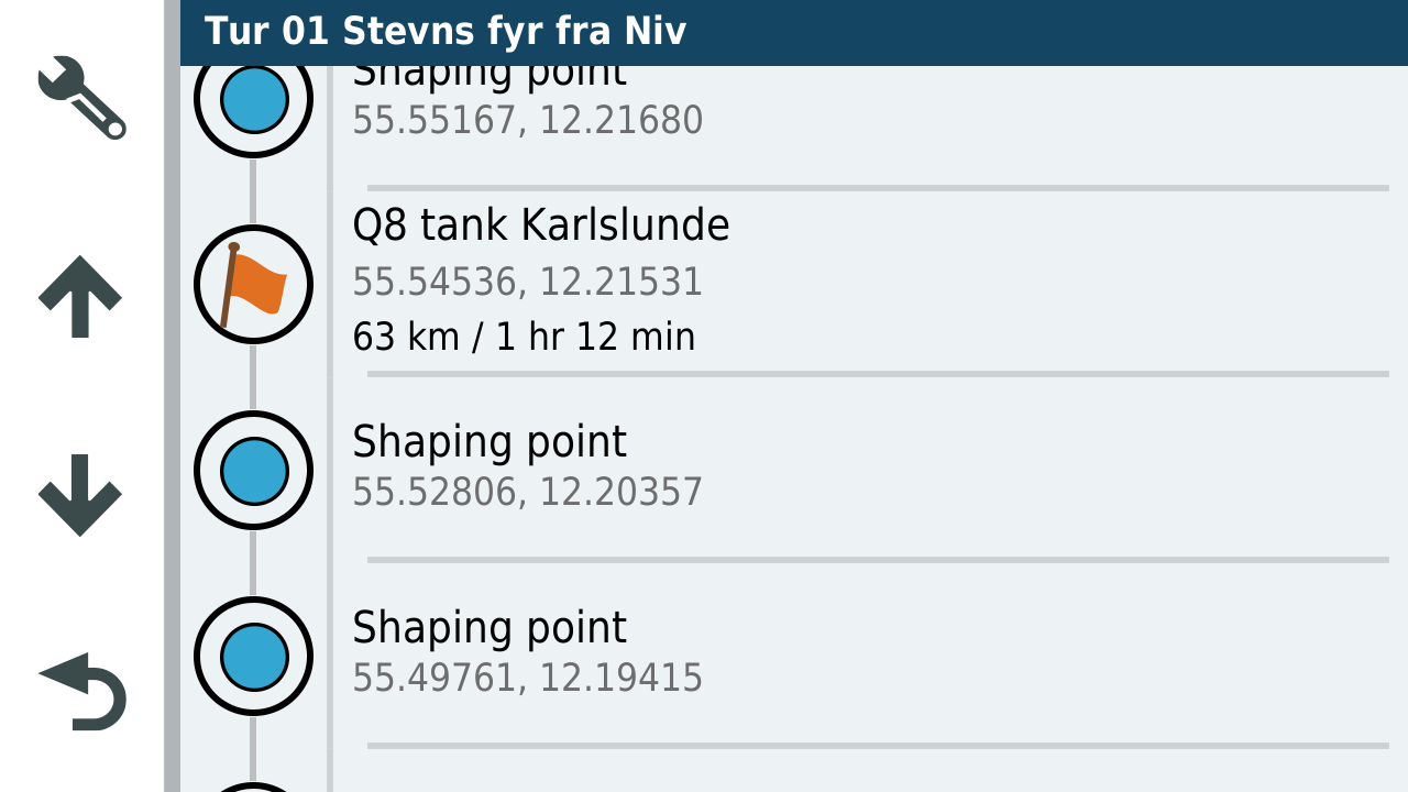

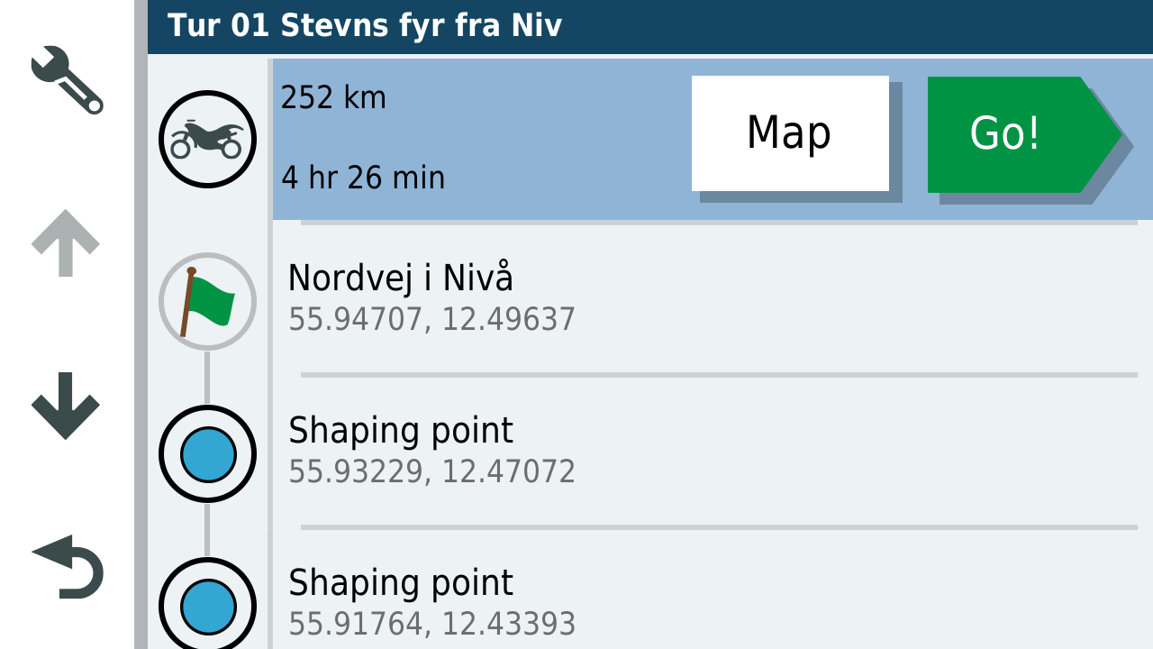

How it looks on my XT after importing.
Frank

I just realized that the issue is with TourStart.... no matter what I do, regarding standard characters (no Danish characters), TourStart will export the file with these CDATE lines.
