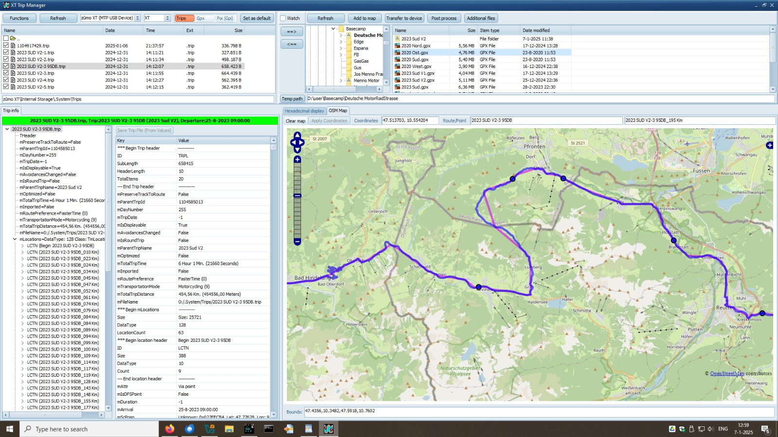

I have created a, Windows 32 bit only, program called TripManager that could be of interest to you. It supports Zumo models XT fully and XT2 partially, and should run on any Windows 10/11 version, and probably Window 7/8, if you dont use the OSM feature, but that is not tested. To get an idea what you can do with this program have a look at this pdf: https://raw.githubusercontent.com/Frank ... erview.pdf

Some of the things this program can do:
- It can fix the trips (RUT) Multi-select supported. Without the need to copy the files manually to/from your computer. The program handles that for you,
- Delete/Rename files (trip, gpx, gpi) on the XT(2)
- Transfer files to and from your PC
- It can help you organise your trip files, by renaming them from a 10 digit number to tripname, sort them by setting a departure date/time, and grouping them.

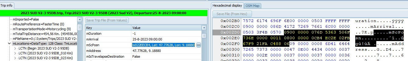

- It shows a lot of info on the trip files. Including a Hex viewer, and an overview on an OSM map.
- You can modify the trip files. Change departure date/time, transportation mode, route preference. Group/Ungroup.
- It can create trip files directly from GPX files. (For the XT2 this may not work) The benefits are that trips are saved (preventing RUT) rightaway, dont need to be imported, are shown grouped in the trip planner, Via/Shaping points retain their assigned names. Basecamp settings for Transportation mode, Route preference and departure date/time are respected. The first time a trip file is opened on the XT(2) it will recalculate.
- It can create GPI (POI) files from GPX files, and display info of loaded gpi files. Including gpi files created by POI Loader. Excluding gpi files that are protected by an unlock code.
- It can post process GPX files. Renaming Shaping points, putting them 'on the road', prevent renaming them on the XT(2).

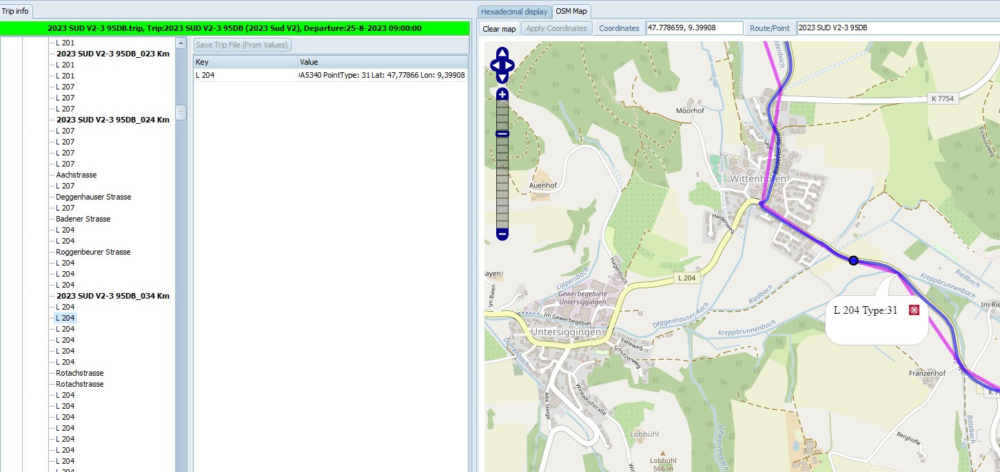

- It can compare, on an OSM map, a trip on the XT(2) with a GPX file on your computer. This way you can check the calculation of the XT(2), maybe you need to add some shaping points?
