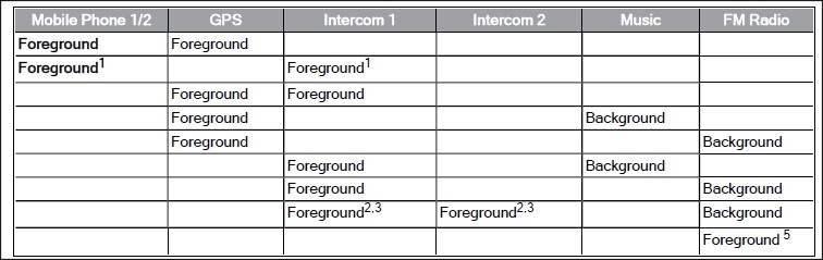

The same facility was available on the autocom wired units - it was determined by which socket you plugged your lead into.
This a table from the Cardo manual.
I cannot make a greate deal of sense from it - it looks as though someone has forgotten to label the rows - but it seems that there are different priorities from different sources.
Edit
Also - I note that in the Cardo App under the gear icon settings heading there is an option to adjust volume levels.
One of them is Audio Mixing Level - which describes itself as
"Audio mixing level is a percentage from the intercom volume during an active conversation."
You set a percentage background volume on a slider
Adjust the overall intercom / background audio music / fm ratio
The language makes that as clear as mud - but the slider is altering background vol percentage - so if you knock that down to near zero - it will just about cut out if you are talking.
