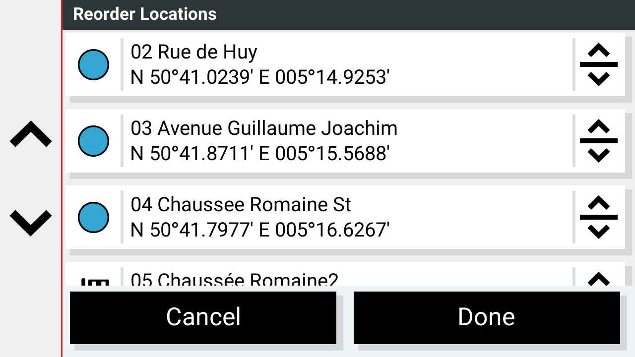

In fact this is a copy of the shaping points on the imported route on the XT2:
It can be compared with the corresponding shaping points in Basecamp:
Coordonnees shapingpoints BC.pdf
(107.96 KiB) Downloaded 541 times
As you can see the names are identical.

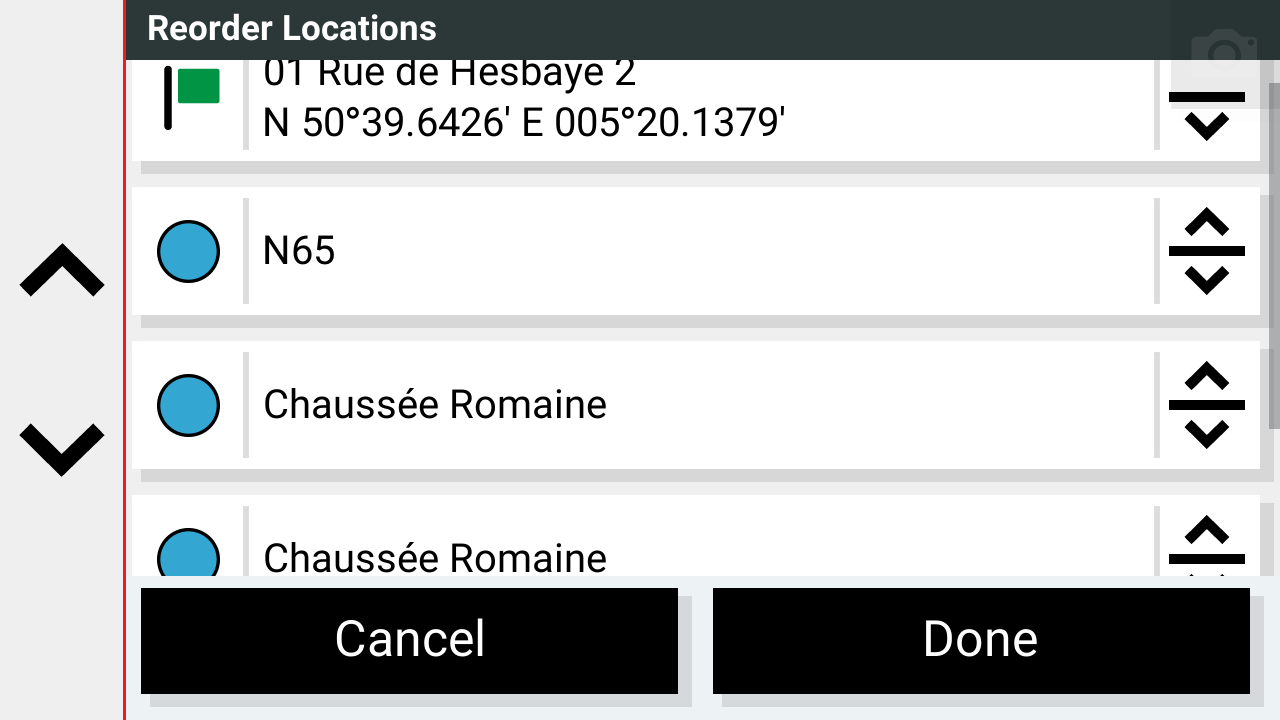

After sync with explore in Tread, this is no more the case. The names are changed and the gps coordinates are no more included:
So, it seems for me that it is explore that changes the name of the shaping points.

Test done. Via points and shaping points defined directly in Basecamp with the "new route" tool, without going through waypoints first.
After transfer to the XT2, the names of the via points are unaltered but the names of the shaping points are completely changed again. The order number is lost, the street number is completed with city and province name, the street number and the gps coordinates are lost.
After recalculation on the XT2, no more changes to the via and shaping points.
If I understood well the behaviour you described above on the XT, the via points are also altered in such a case on the XT? This is no more the case on the XT2. The name of the via points are unaltered.
So jfheath, it seems that we still have to stick to your trick with the waypoints on the XT2 too if we want to keep the names of the shaping points...
