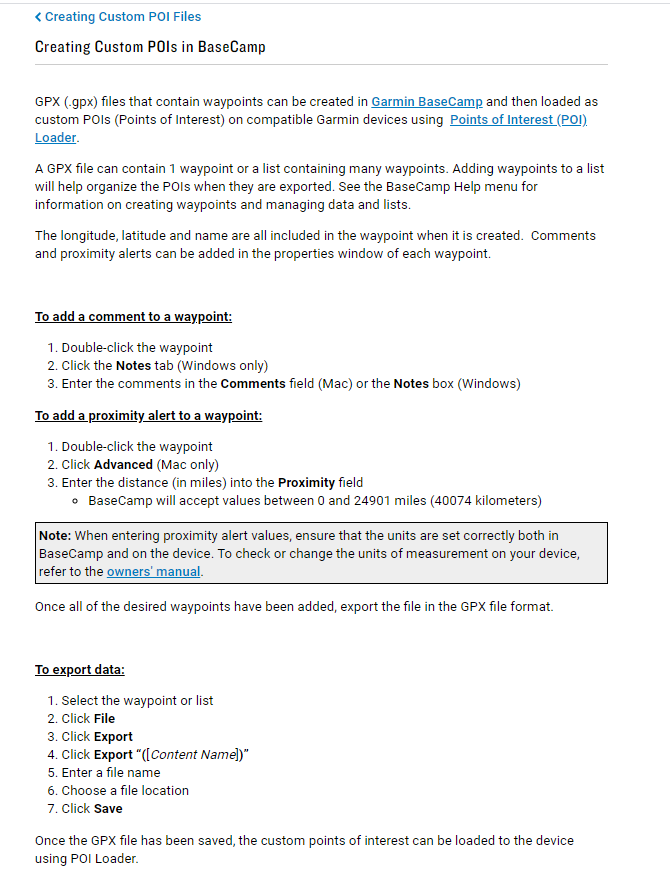

I have POIs on my device. I loaded them with the POI loader. I have followed these links and none of them talk about a ".gpi file" You have referenced ".gpi file" quite a few times. BaseCamp makes the file a .GPX when I export it, just like the directions say:
https://support.garmin.com/en-CA/?faq=T ... H7hQQyEet7
Capture 1.PNG (113.43 KiB) Viewed 3451 times
The POI loads the .GPX file and I have them on my GPS as that is where I am saving them to.
If I save them to my computer, then the POI loader makes the file a .GPI. But then what? I tried to import the .gpi file into BC. But it wont recognize it.
What is the difference from GPX and GPI?
Other than being able to load the GPI file what good is it? How can I view it?

I'm not sure why you're struggling with this, let me try to explain.
Garmin POI files end in .gpi, Favourites (or saved places on some devices) end in .gpx. POI files normally are in the POI folder on your device, Favourites in the GPX folder.
To navigate to them on the device you either do a Where to, Favourites or a Where to, Custom POIs although depending on the device there may be some steps in between the Where to and either Favourites or Custom POIs.
BaseCamp can import gpx files but not POI files, however POI files can be viewed in BaseCamp via the Maps menu in the toolbar, you'll see Manage Custom POIs at the bottom, which will be greyed out unless you have a device loaded with Custom POIs attached.
You can obtain Custom POIs in numerous ways. Some folks create them and you simply download the .gpi file and place it in the POI folder on your device. You can create your own by following the wizard in POI loader. When you 'load' a gpx file from BaseCamp into POI loader it creates a .gpi file from your BaseCamp file or indeed any other gpx file.
POI files are useful in that they can contain many more locations than the maximum number of favourites you can have on your device. The downside is once they are created you can't add to them without creating a new .gpi file.
