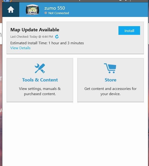

It's a mystery. None of that appears in .24 or .23 versions. What I get with both versions is the below:
Well, thought I could add an image, but guess not. Regardless, I don't see anything like you posted.

" None of that appears in .24 or .23 versions. What I get with both versions is the below: "
Click on "View Details" to see the rest.

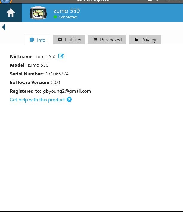

Already tried that:

I notice that yours shows the 550 is Connected. Mine is Not Connected.
Disconnect the 550 and try again.

Hi gbyoung2,
on your picture image there, zumo 550 connected,
I see that it shows (Info folder),
and on my Express Info folder comes when clicking the Tools & Contents box
the options for map dowload files is not under that box.
on my Express, the option for download map files is under Estimated Install time, you will see View Details
click on View Details, which is right under Estimated Install Time
when clicking on View Details, it shows another page, 1 Update Available page
on that page, click on Installation Options
under Installation Options is where you Select where you would like to install the files.
