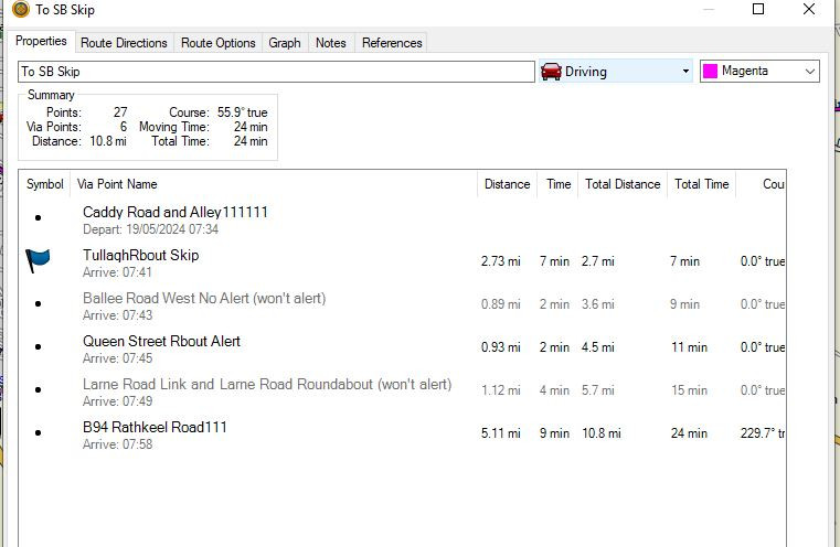

Waypoint? Viapoint? Here's the Route detail created in Basecamp. As you can see the Start, 2nd and 4th points alert, but only the 2nd has a flag. (I use the Route creating tool, I don't normally create Waypoints and then "join them up"). Apologies - I forgot I'd changed the original route to use backroads (B roads here) - on Skipping the 4th point the Xt2 did actually reroute to use main (A) roads to the destination.

That is the behaviour we talk about when saying that it recalculates the remainder of the route. Did the main (A) roads it chose route through the fifth point?Triplog wrote: Sun May 19, 2024 6:54 am Skipping the 4th point the Xt2 did actually reroute to use main (A) roads to the destination.
Regarding terminology (Waypoint, Via Point, Shaping Point), notice in your route points list that some are gray and contain "won't alert". Those are Shaping Points. The others are Via Points (alerting). All are referred to as Waypoints. These are my notes-to-self on the subject:
Once you have created and saved a Waypoint, it remains a Waypoint.
The Waypoint may then be used in a route or just saved for future use - (In the XT this is a 'Favourite' in UK; a 'Saved' in USA)
When created, these points are always created as Alerting route points.
Another type of point is a ad-hoc inserted point (a point created the "Insert" tool).
A point created using the rubber-band method (Alt+drag) is the same as a point created with the "Insert" tool).
These points may or may not be created as Alerting points, depending on whether that route point is a known address on the map.
Any of these points can be set as Alerting or Non-Alerting points.
A Via Point is an alerting Waypoint or an alerting ad-hoc inserted point.
A Shaping Point is a non-alerting Waypoint or a non-alerting ad-hoc inserted point.
