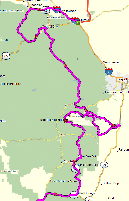

I have an XT2, I use BaseCamp for all my route planning, and I live in the US. I add the last part because maybe the underlying maps are at fault. I was having issues getting what I created in BC to show up on the XT2 until I read https://www.zumouserforums.co.uk/viewtopic.php?t=1464" and ensured I had my GPS and BC set up as per the instructions. I have had very little issue since then.
At any rate, this summer I did a 33-day road trip. Every riding day was planned out in BaseCamp ahead of time. The only day that the XT2 simply flubbed the routing was the day I was in the Black Hills of South Dakota. On that particular day the route did a figure-8 and crossed over itself, which I suspect made the XT2 go "WTF?!" and decide it knew better than I did. Every other day resulted in the same route I'd planned out.

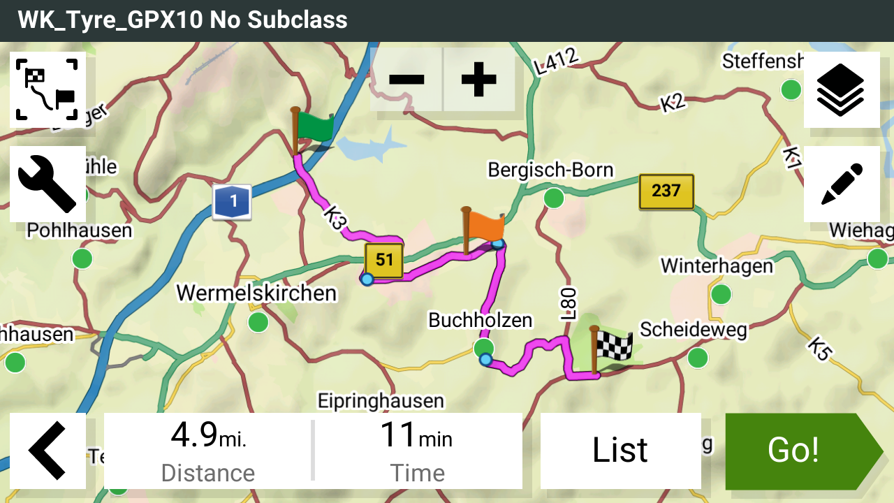

The short one WK_Tyre_GPX10 - that loaded in straight away. I didn't load it into Basecamp, so I didn't recacluate the route to ensure that the maps matched. The route was recalculated and most of the shaping points were moved - including the one at the East end of Albert Einstein Strasse designed to keep the route away from Route 51. With that gone, that section of the magenta line ended up on Route 51. Not good - but that unfortunately is what happens when you use a Basecamp route.
The route itself is still regarded as 'Imported' as opposed to 'Saved' - and that means that it may be susceptible to the RUT issue.
So I tried removing the subclass entries from the gpx file and loaded that. That took slightly longer to load but the route and shaping points were retained as they were. Screenshot below.
When the Tread app on my phone receives this, it recalculates it. The next time the route is selected on the XT2 screen, it has adopted the recalculated route.
So far, the only way that I have found to prevent this is to turn off the BlueTooth link between the XT2 and the phone. Or remove tread completely.
[edit] - Except - I have just tried again and although the Tread app is always running in the background, I haven't selected the Tread app to view the map on the phone's screen, and it is not open as a quick access window. The modified route from Basecamp (without Subclasses) has not changed. It has been sitting there for an hour or more. The route synchronised with the EXplore database - but that hasn't got to the Tread App, and it hasn't got back to the XT2. Nothing has changed. I've simulate driving the route and it worked fine. I also used the XT2's route editor on a section of the route and changed it to shorter distance. Accepted that, Then saved it back to Faster time. Saved that - The route went back to the original but now the Route is regarded as having been created on the Zumo XT2 - not imported. That is the indicator which prevents a RUT situation developing.[/edit]
The problem is when testing this - there is such a massive delay in the synchronisation between the two units, and the XT2 doesn't keep checking - so the route stays the same until you change screen and it has to reload it - and then you notice that it has been changed.
