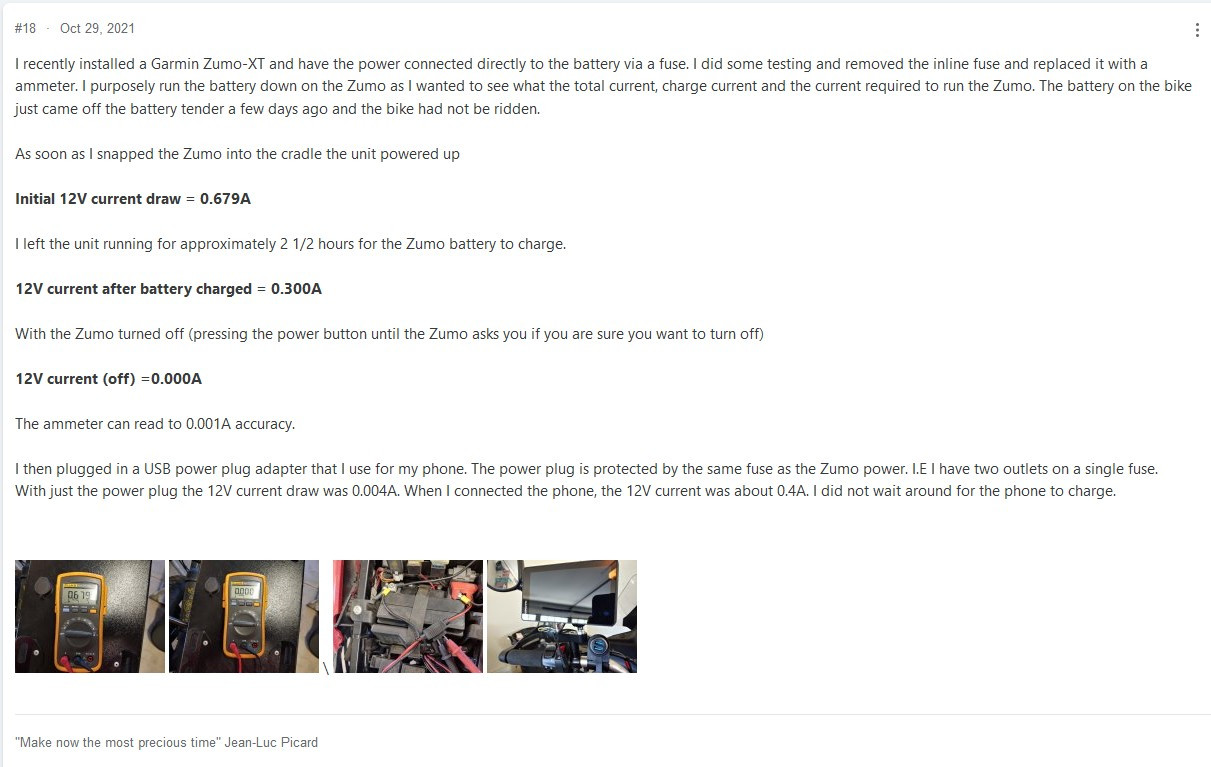

Cant remember where I found this, maybe it helps

Very good, thank you. I am just about to wire in a waterproof connector so while I'm in there I might conduct a test of my own to confirm.

FrankB wrote: Wed Apr 12, 2023 11:15 am Cant remember where I found this, maybe it helps
Found the URL: https://www.stromtrooper.com/threads/zu ... st-5588065

Thanks for the link. I have now performed my own test and can concur the draw is 6.97 milliamps, so as near as damn it 0.7 of an amp
