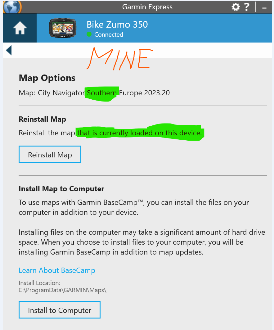

My first problem was the Zumo telling me it could not "unlock the map" but after some ill advised botched attempts to fix it I now find it is (re)installing "CN Southern Europe 2023.20" and to Internal Storage (8GB) (full Europe has to use the 16GB SD).
There is no "Manage Maps" button, only a "Reinstall Map"
I'm looking for a way to go back to "CN Europe" and make it use the SD card.

CN Europe NTU
2023.20 Southern Europe
If your refering to the Purchased tab in Tools & Content. That just says "There is no content for this device". There is also a message "We're having trouble retrieving all your purchased content."

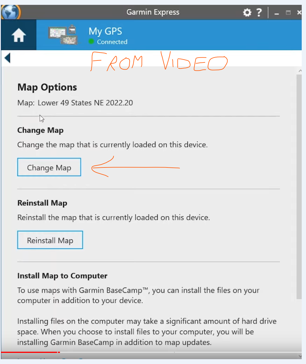

Yes clearly and if I had a change map button I would try it.
The video has a "Change Map" button but my Zumo does not. After a "Reinstall Map" I still have just Southern Europe.
Latest garmin Express 7.15.2.0, tried both Windows 10 and also MacOS 13.1
Screenshot 2023-01-07 124908.png (403.71 KiB) Viewed 8255 times
Screenshot 2023-01-07 125133.png (134.18 KiB) Viewed 8253 times
