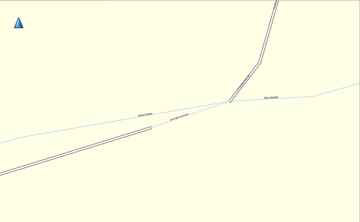

Re: Route planning frustrations!
eureka!!
Found the issue! Google and TomTom maps are correct and Here maps is wrong :roll:
Here maps shows it as no through road when in fact it is and even on street view it shows cars on it :lol:

Posts: 1857
Has liked: 380 times
Been liked: 384 times
Yet BaseCamp allows routing using the activities I mentioned above. Either Garmin is using an earlier HERE map or Garmin have corrected it.
