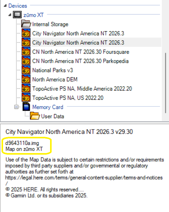

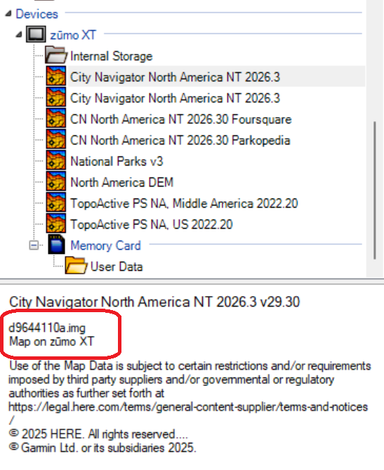

I am revisiting this as I can't find the answer to one of the questioned asked. In the snips below you can see that I now have 2 different identical map files on on mt XT internal memory. I just finished updating the XT firmware and maps. I cycled power on the XT and now have 2 seemingly identical map sets. This is the first time I have ever seen this. Is this normal? Is it just filling up memory unnecessarily? And how do I delete one of them?

Re: Two maps in the Zumo XT? And other problems incomprehensible for me
Click the other map and you will see that it has a different name than d9644110.img.
The two maps are not duplicates, they contain different data. One is the U.S., one is Canada & Mexico, together they make up North America.
The XT uses a FAT32 file system which restricts the maximum file size to 4Gb. The NA map was split this way several years ago when the maps grew too big to fit in one 4Gb file. If you install the map to your computer, it will likely be stored using a system that allows much larger files, and all of NA will be in one file.

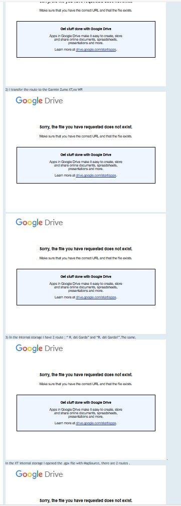

I don't have Google Drive Installed - - so I am unable to help. (I don't want Google Drive installed - a personal choice)
So all I can see from the original post is this :
GoogleDrive on ZUF.jpg (54.77 KiB) Viewed 1479 times

jfheath wrote: Mon Nov 10, 2025 11:14 am I don't have Google Drive Installed - - so I am unable to help. (I don't want Google Drive installed - a personal choice)
So all I can see from your posts is this :
As the original post is from 2022, it looks like the file link posted is no longer accessible. It's either been deleted, or the link is no longer active.
You don't have to have a google drive account to be able to access files, IF, the shared links are setup with the proper security profile.
