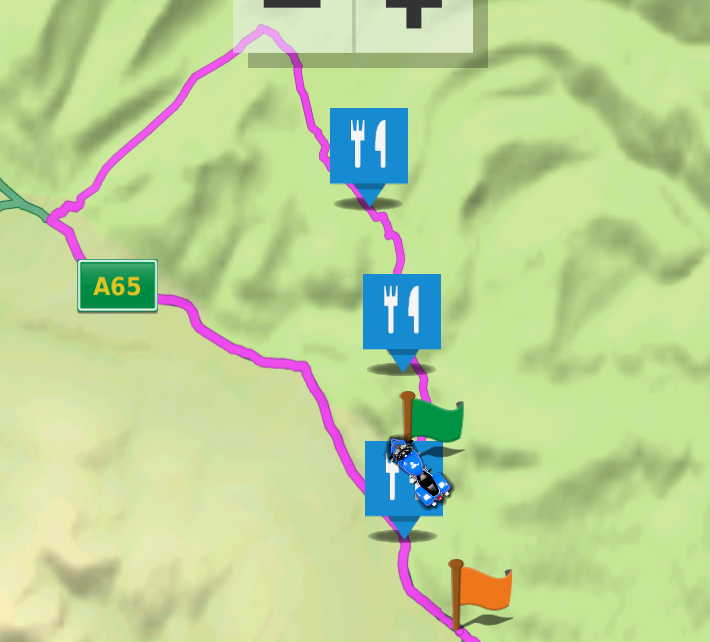

Zumo XT - Skipping a Route Point - Weird Behaviour
I reported an issue a little while ago here: viewtopic.php?t=1582
I now have some explanations as to what I believe was happening.
Just a reminder. I was following a route that I had plotted. The Zumo decided that its 17 mile route faster, and I decided my 12 mile route was better, and ignored it. There was only a minute in time difference, so that's OK. I took the route that was more fun to ride.
I expected that after I had ridden a mile or two, the XT would give up nagging me to go back and start to navigate me ahead to the next route point which was plotted a mile or so after our two alternatives met up. It didn't and kept nagging me to go back. Here is the screenshot. The orang flag is the Via Point. The bike is heading south and is 2 miles from the Via Point. The route is what the XT is telling me to fo. Go back to the corner at the top of the map and continue down the road that it has plotted. 28 miles to reach the Via Point that is just 2 miles ahead.
(Ignore the restaurant symbols, they are not relevant).
Normally, when you deviate from a route with Via Points and Shaping Points, the satnav will recalcaulate a new route to the next route point. That works perfectly OK. Except on this occasion, it didn't.
Why Not ?
Well there was a difference. Part way around the route I had pressed skip - because I didn't want to visit a particular Via Point place about half a mile of route. And then I continued 8 miles to where I had the problem.
And that was the difference. I had pressed Skip. Now something else odd happens when you press Skip - it recalculates the entire route - not just the section to the next route point. Normally with a route if you deviate it just calculates to the next route point.
But I now believe that it uses the wrong algorithm to calculate the route after pressing Skip. I think that it uses the Track-Trip algorithm.
So instead of a magenta line with the characteristics of a normal route, it seems to produce a magenta line with the charactersitics of a Trip Track.
In fact when I tried to edit the current route after pressing Skip, I got the identical message that I have seen when selecting Edit when a Track-Trip was active. It warned me about the dangers of editing and the fact that it would turn it into a normal route. So I can only assume that this new magenta line produced after Skip was pressed, was not a normal route.
So when I deviated from the magenta line that it wanted to take me on, It appears that I wasn't deviating from a normal route as I believed. It seems that I was deviating from a Track Trip. And Track Trips do not budge. And the subsequent behaviour was extremely similar to the behaviour that I discribed above when my Track Trip had picked out the section of the route home.
I can't think of any other explanation except that the nature of the route had been changed to a Trip-Track, and that this was a consequence of pressing Skip.
So - the current situation is that if you are following a route, and you deviate, everything works as it should. The route gets recalculated to the next route point, and all is well.
If at any point you press 'Skip' in a route, the route also gets recalculated. But the route that it produces now seems to have the properties of a Track Trip. And if you deviate from that, it takes you to the closest point on the original magenta line, which in my case was always going to be behind me.
Remeber that scene in Wallace and Grommit - The Wrong Trousers - with the pair of them on a model railway and Grommit is feverishly laying down the track in front of the engine ? - Well this was doing something similar - except it was laying dwon track behind me so that I could turn round and follow it back.
At the moment, Skip seems to be a very dangerous button to press. Stopping the route and restarting it using Closest Entry Point may be better. But I haven't tested that.
I reported the original issue to Tech Support and had a few very lengthy email exchanges. I've now reported this discovery. It seems to me to point to the solution - but only they can choose whether or not they fix it.
