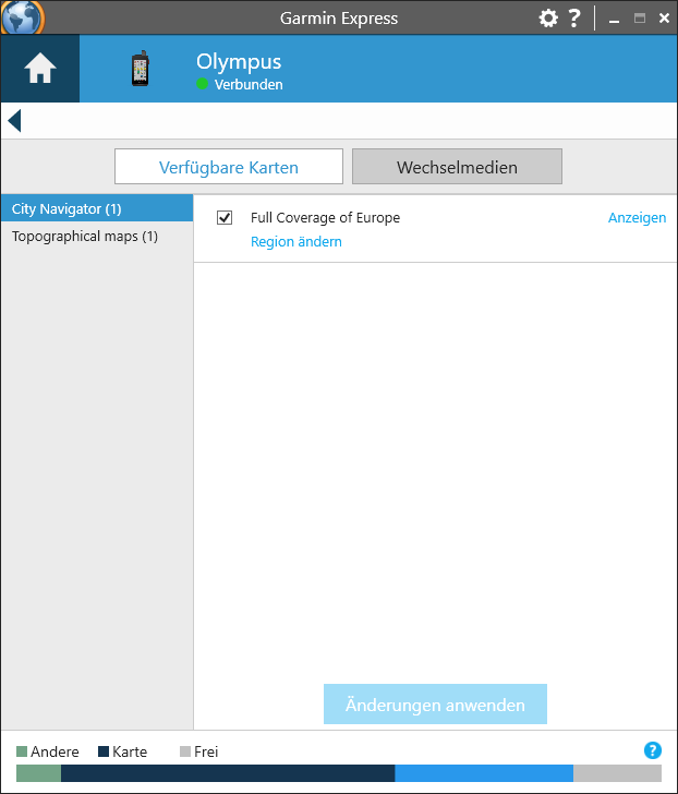

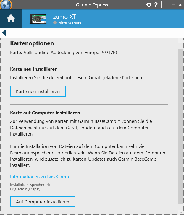

The only maps, you could install on PC, where the City Navigator maps - all other (Topo, iOverlander) are unit-only. For CN there was a option, to freshly install it to the unit and also install it on PC for fast access with BaseCamp! With the new firmware 5.90 there is a brand new map administration and the option to install CN also on PC is completely gone!
Here's a screenshot of CN map installing options with the 'old' firmware 2.90 (it's in german as i'm from austria)
You can see 'Karte neu installieren' which means a fresh install of the map on the unit and below there is 'Karte auf Computer installieren' which means Install map data on the pc to access it with BaseCamp - this options are completely gone with the new map administration, if you are already on firmware 5.90
The 'new' map administration looks as following (screenshot from another Garmin unit, but the same on Zumo XT with 'new' firmware - no more option to install the map anywhere than on the unit itself):
