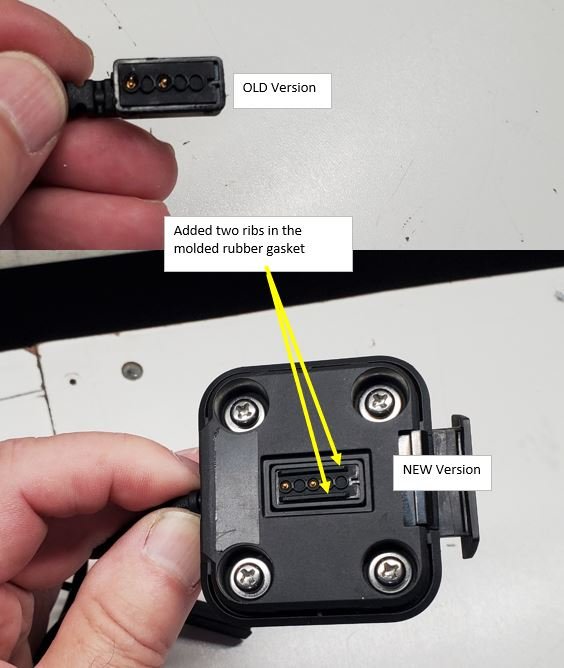

Just an update on the new mount:
- Have used it for some month now. Still see the loss of power, but not as frequent as with the old mount.
- One of my friends, also with the new mount, is also having the issue.
This is my 3rd mount, the first two was both with the old connector, but the 2nd was with the tape added for improved stability.
Not sure if I wan't to call Garmin again. They seem not to be aware of this issue here. Last time, the guy completely locked up, as I apparently told him a wrong procedure, when asked, for resetting the device (I have a 220, 390, XT and a 3490 in the car, so confusion might have happened).
Never had any power issues on the other units, except I broke one of the pins on the 390 connectors myself at some time.
Might just try to return it...

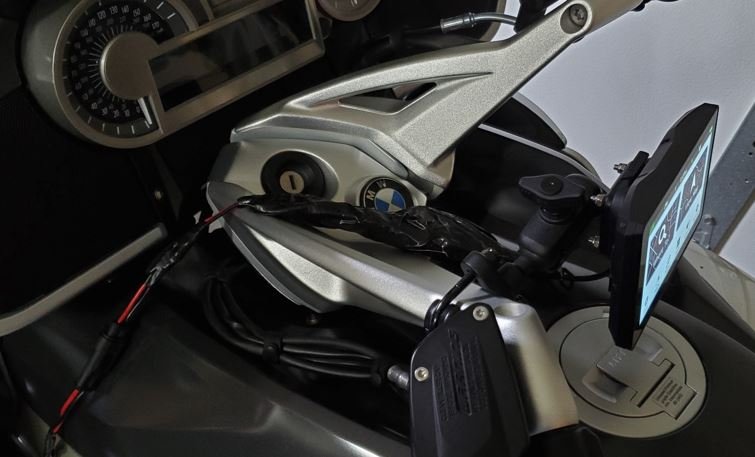

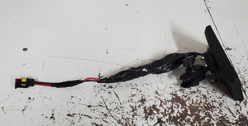

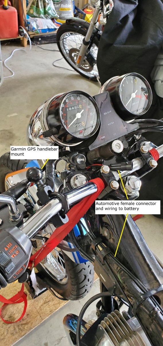

Re: WARNING - Garmin Zumo XT hot-shoe connector weakness
Hi Stu, I received a replacement connector from Garmin quickly and at no charge. That's nice but I really didn't see much in the way of design improvement. So I decided that I would add an automotive grade water proof connection at the other end. That way I can leave the Garmin mounted and move from bike to bike using a RAM mount and an automotive connector. Hopefully, the pogo pins will last longer if I don't have to interface with them very often. I wanted the capability to easily move the Garmin from bike to bike so this should work well for me. It isn't the most elegant solution but I believe it's robust and weather proof. The nice thing is if the automotive connector fails out in the middle of nowhere, it can easily be fixed.
