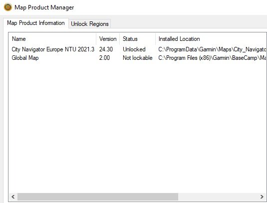

It seems, that Garmin Express 7.6.0.0 is faulty, at least with Windows, as I can't test Mac. While you can install City Navigator on computer, maps are not being unlocked and BaseCamp will complain, that maps are not authenticated. This only happens with devices, which use this new map management, like Zumo XT or Montana 700 series.
Can anyone confirm?
All older devices, like Zumo 590/595 are not affected.

Thats odd, maybe its a windows 10 thing, Mine has installed and its showing as unlocked. I have a Zumo XT. Maybe try running as Administrator ?
Re: Garmin Express 7.6.0.0 released
This "run as administrator" question could use further discussion. I have three users on my PC: Admin, Me, and TestUser. Best I can tell, for each user to be able to access installed maps in Basecamp they must each install the map to the PC while their user privilege has been temporarily elevated to Administrator. Starting GE with the "Run as administrator" doesn't seem to work.
That said, I have not been able get the maps unlocked for TestUser even after installing with admin privileges. Firstly, it doesn't make sense that map installation and locking are user specific. Secondly, I now suspect the TestUser lock problem is due to the GE 7.6.0.0 unlock issue but again, why the heck is map installation/unlocking specific to each PC user??? BTW, the trick of unlocking by copying the D6210120A.gma file from the device won't work for me because that file doesn't exist on the device. Perhaps that file is device or map specific? I have a zumoXT and the CN NA 2022.1 map.
