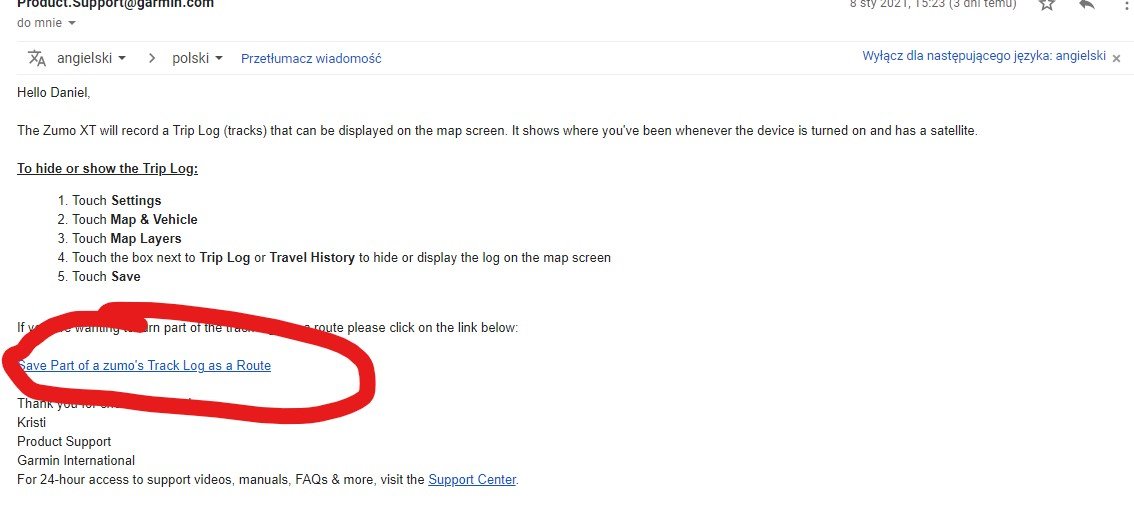

I wrote mail to Garmin Central with one simply question - calculated route (from own track) should have start and end only OR start, many middlepoints, end. We will see...
You are right, ZUMO service is incompetent. They have big problem, but they don't say anything.

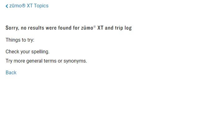

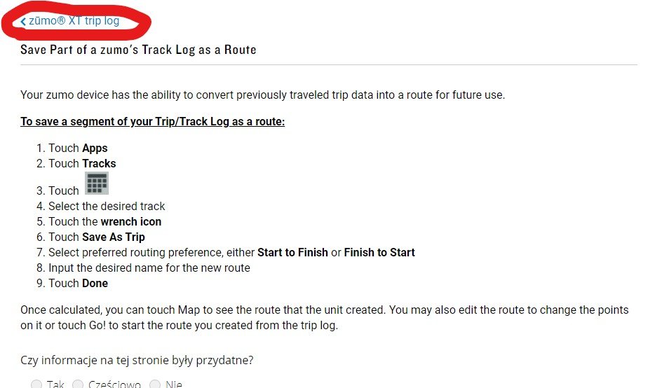

We have another clue - garmin is hiding something
I tried to force garmin support answer my questions.
They sended me only part of manual
picture 1 with this link
https://support.garmin.com/en-US/?faq=s ... tab=topics
You can click and see this,
picture 2 but when you click "ZUMO XT trip Log upper left you see that page is removed, you can't see this from normal www tree
picture 3
picture 3
