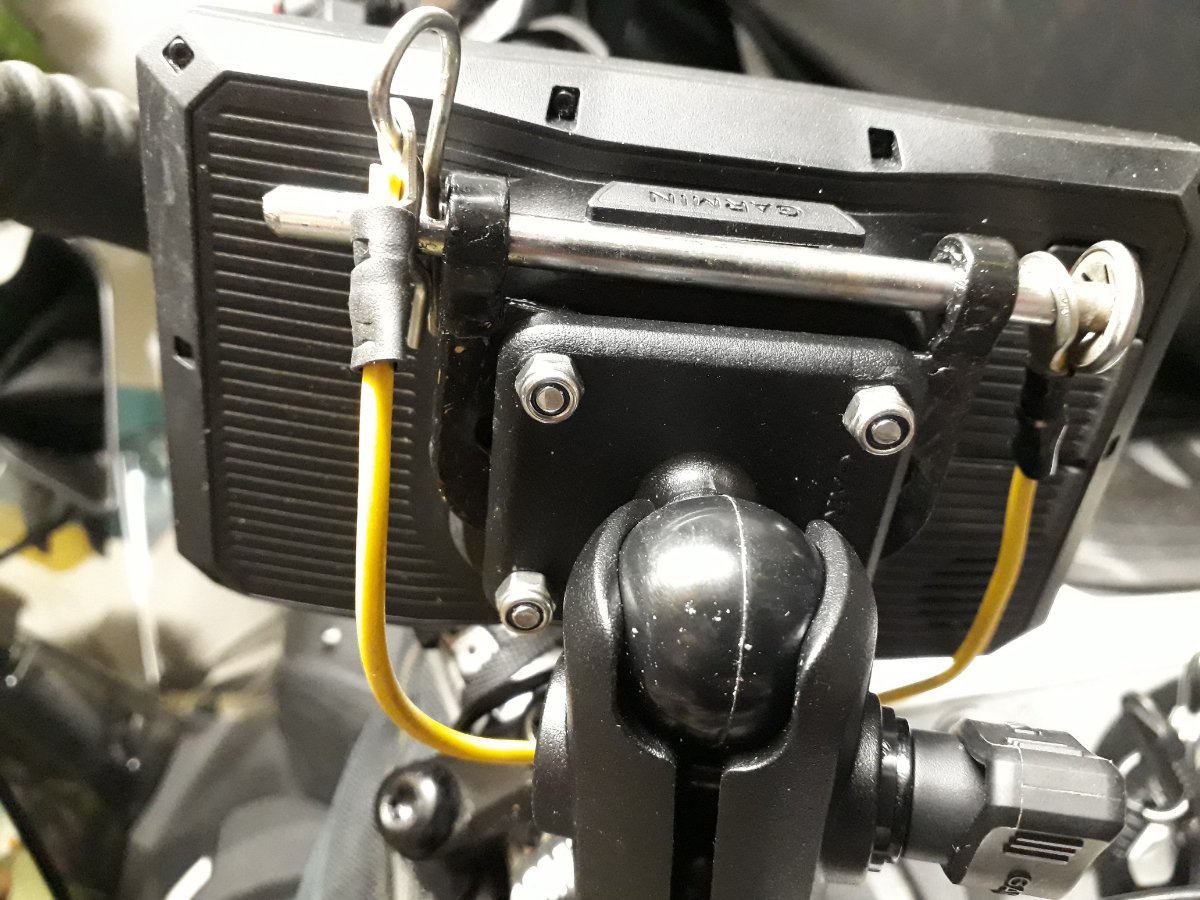

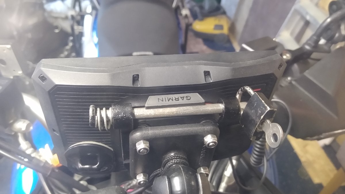

No happy about my XT not being very safe and secure while on the bike ,ie at petrol station /paying for the fuel, all it needs is a quick press of the mount clip and it's off and away by some vilian ☹️
To act as a deterrent and make it harder to be stolen, I decided to make a simple and cheap solution.
The idea is that the clip can't be pushed down to release the XT from the mount, plus I added a tether for extra security.
Took about a hour to make , a bit crude but effective , if anyone interested in how it's made let me know.

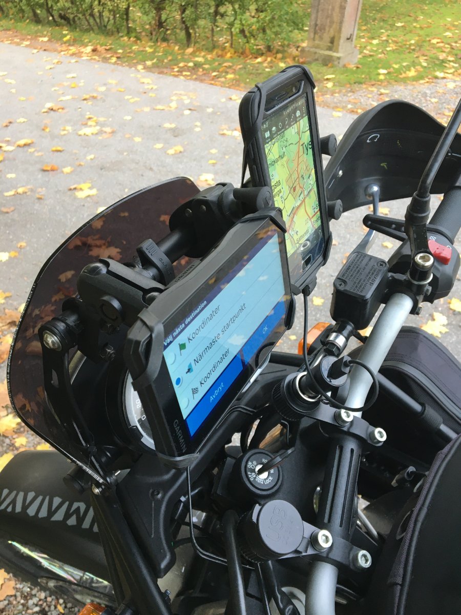

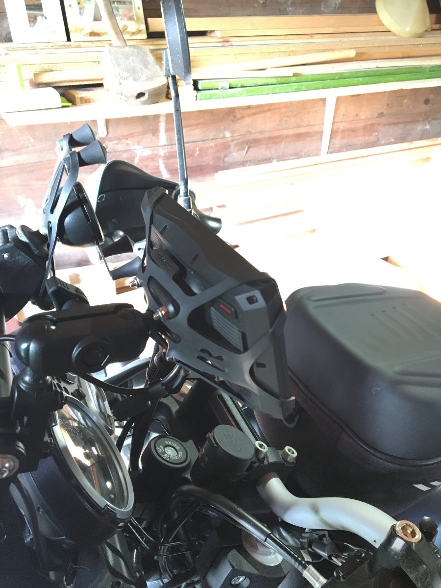

Not a locking device but an easy and cheap way to have Zumo XT securely attached to the mount: I just bought RAM rubber strap (RAM-HOL-UN10TU), se attached photos. Works great :-)

I think that looks like a great solution for those who feel they need a tether. I was concerned the rubber straps would cover the corners of the screen but, it looks fine. And unlike a tether you don’t have to glue anything to the back of the XT.

Today I make a "locking device" Thanks "woodyflyer for the idea
