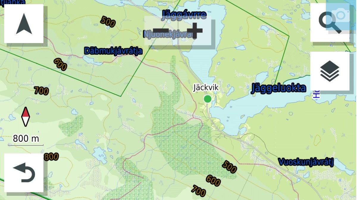

In meny Garmin device you can use own typfiles but not in Zumo xt, someone who has a solution? Garmins topo map are horibble without retyping
- tetyped
- Jäckvik omtypad.jpg (254.78 KiB) Viewed 4283 times
- Garmin original
- ori typfil Jäckvik.jpg (137.97 KiB) Viewed 4283 times

the XT uses themes not typ files. According to this page: https://www.pinns.co.uk/osm/theme_editor.html the TYPWiz editor can convert typ to themes.
I have not tried this myself yet, I did however edit my themes.
Look for some more info about editing themes in this thread: viewtopic.php?f=48&t=730&p=4641&hilit=themes#p4641

I have now tested installing own typfiles in maps to be used on Zumo XT.
It works fine. The installation procedure is not different from what you use with other Garmin models. But the map needs to be licensed for the GPS.
Within a few days you can download typfiles for Zumo XT for City Navigator 2021.1 and Swedish Topo PRO V6 from http://resmark.se/gps/hmrtyp.zip

Yesterday I made new typfiles available. Now tested also on Zumo XT.
