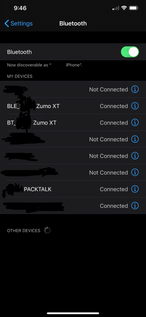

I followed the sequence you mentioned and it actually fixed issues #1 see picture attached. I need to check call status when I will in DMC mode. Don’t have riding in my weekend plan. Hope this will work as well. I will report once tested.

- B2D8076E-7A58-4692-9281-ED73683B89DF.jpeg (75.42 KiB) Viewed 8713 times
