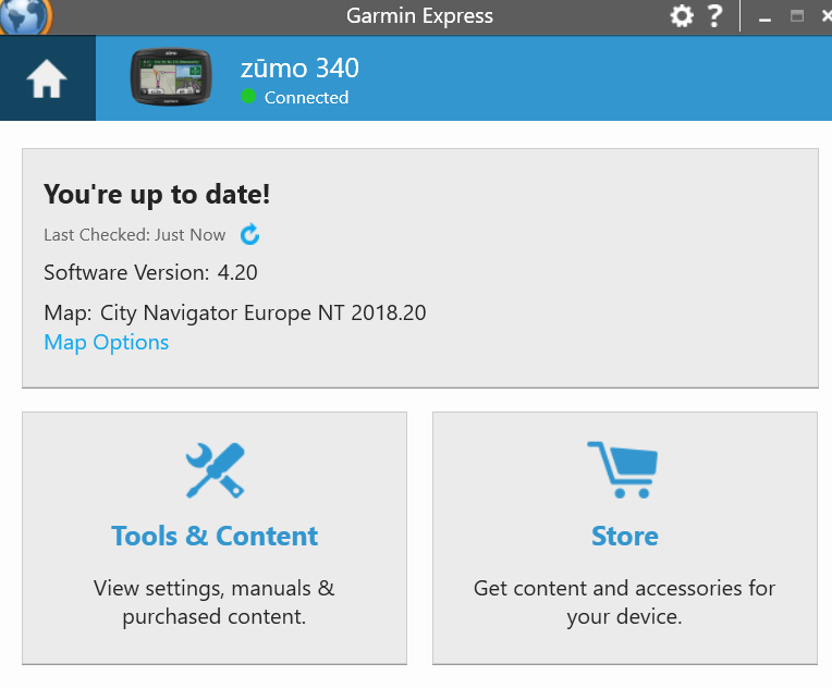

Right now I have just the one freshly created garmindevice.xml file and I've reconnected the zumo to the PC, but Garmin Express still shows up the 2018 NT map, as if that is installed.
could there be something wrong with my Garmin Express install? I just installed it to the default file location.

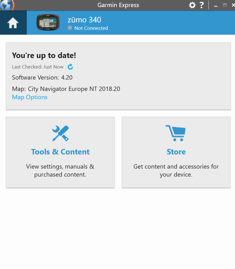

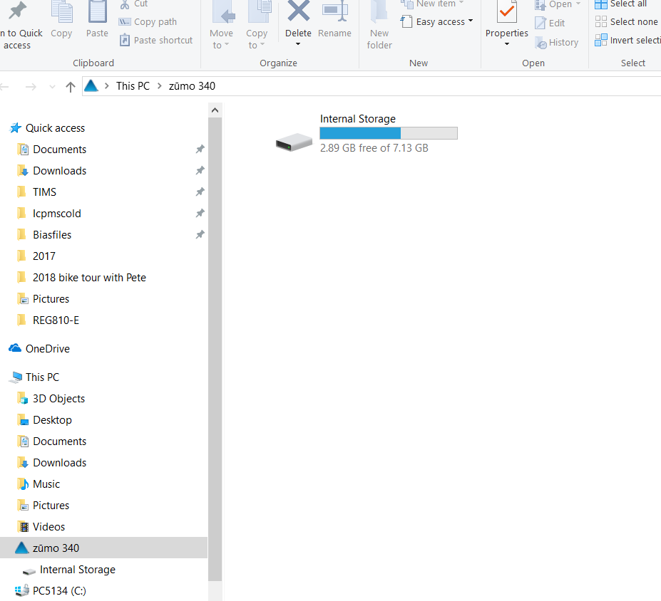

so I switched off zumo, removed external memory card.
now it looks like this in file manager:
and then started up Garmin Express and get this (i.e. same as before)
