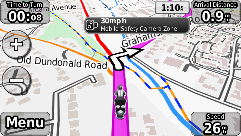

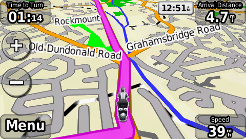

Whether speed limits are displayed or not is the choice of the person garminising the OSM mapping. The look of the map can also be changed. I do my own now using MKmap and Splitter (which are command line utilities)
Here is a few screenshots of various maps on an old NAV IV (Garmin 660) in simulation mode.
Freizeitkarte
Alternativaslibres
My OSM Map
Garmin Map NT2025.1
When I make my own maps I tend to keep with the Garmin look and feel and don't include speed limit info (it tends not to be that accurate anyway even with Garmin's Here mapping). As you can see from the Freizeitkarte and Alternativaslibres maps if you create the maps yourself you can customise the look and feel. My own maps even work on my First GPS a Streetpilot 2610 which last had a garmin map update in 2008.
