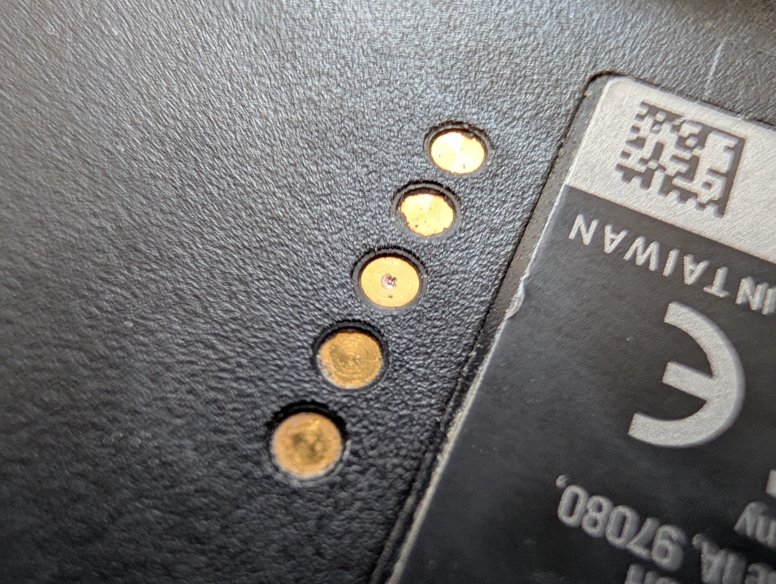

Re: Damaged Electrical Connector
The rubber was an excellent shout and has got rid of the of black spot.
The two combined now mean that I’m not getting the loss of power anymore so thank you both for that.
However the contact on the back is damaged. Should I be worried and look at repairing it or just leave it and see how it gets on. If it’s repairable I’d rather crack on and do it rather than leave it till it can’t be repaired anymore.
Photo attached
Photo attached
My opinion is that the contacts on your XT are not repairable, but they can be cleaned and protected. The product I mentioned before, Deoxit, is used by pros in the music biz to keep contacts in mixing consoles clean and noise-free, because editing noise out of a mix costs lots of time and money. I carry it on all bike trips.
So the only repair I would do is a thorough cleaning with Deoxit cleaner and then a coating of Deoxit Shield to protect the contacts. Here's some info on Deoxit:
