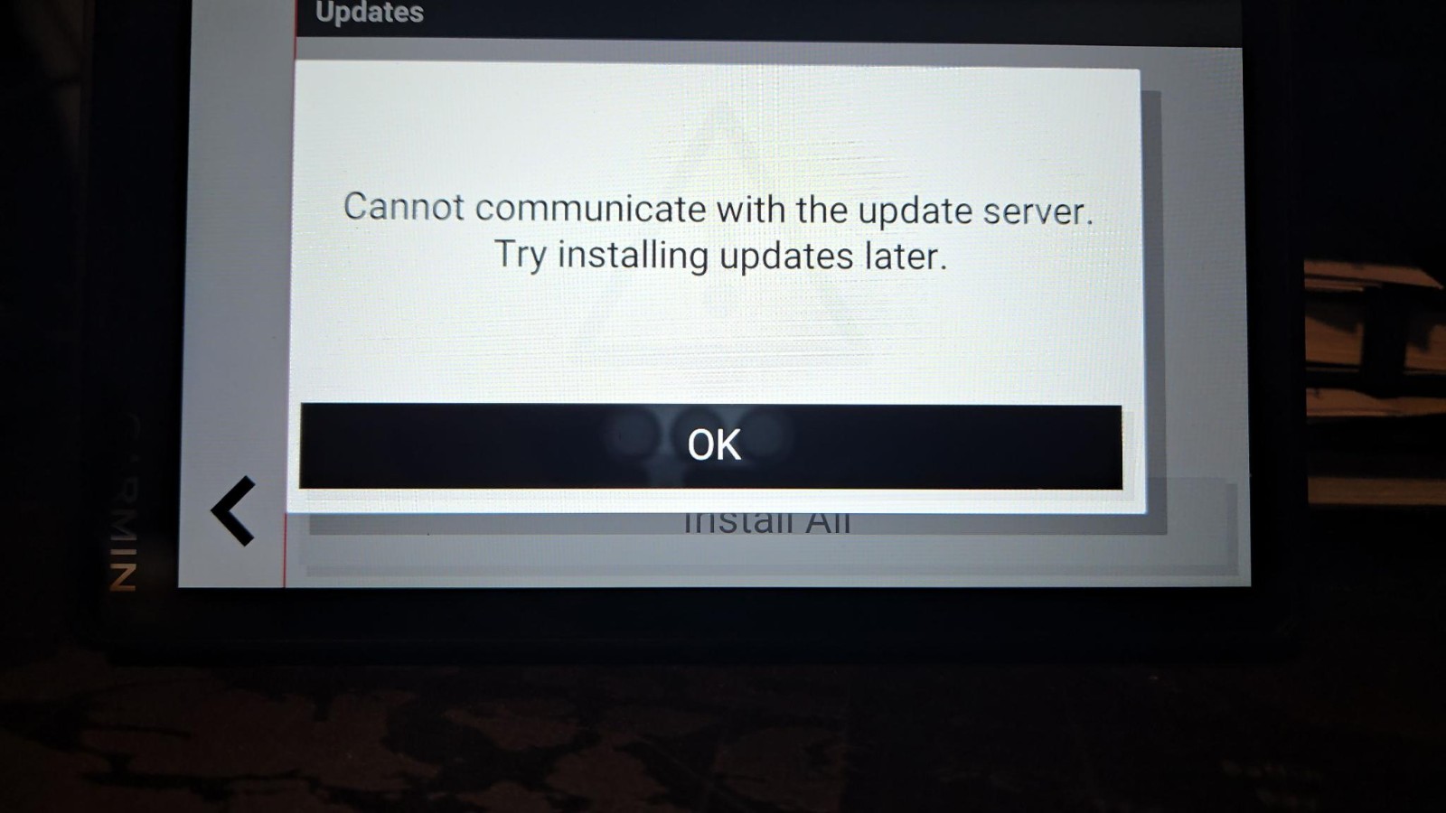

Anyone else seeing this OR is anyone else actually getting connected to the update server?
I have been seeing this for a few weeks straight now. I suspect it may not be coming back. If so, it's another failed feature for which I really thought the XT2 would be a winner. Instead, I'm the loser. Fool me once, shame on you. Fool me twice, I guess I'll buy a TomTom.

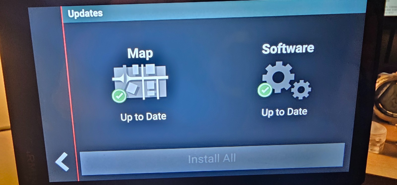

My router is not the problem, it seems my ISP is! I created a hotspot with my phone, connected the XT2, then it seems to connect to the Update Server just fine. When I did the same using my Major Canadian Internet Service Provider (rhymes with HELL) it won't connect.
Interesting.
Goes to show, not everything is Garmin's fault! Lesson learned.
