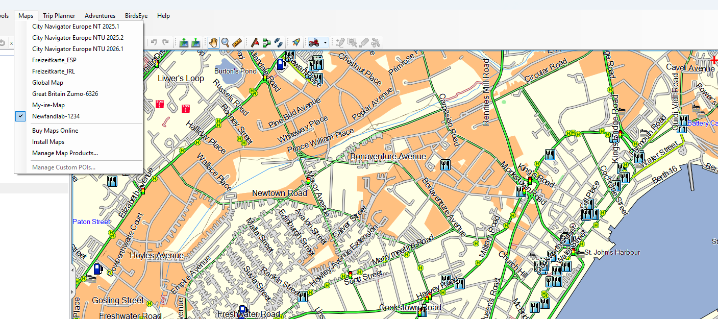

This is my first test using the Zumo XT map format of Newfoundland (as it was a small file to process)
The Map Section is St. Johns
Screenshot 2025-04-13 201835.png (745.24 KiB) Viewed 6077 times

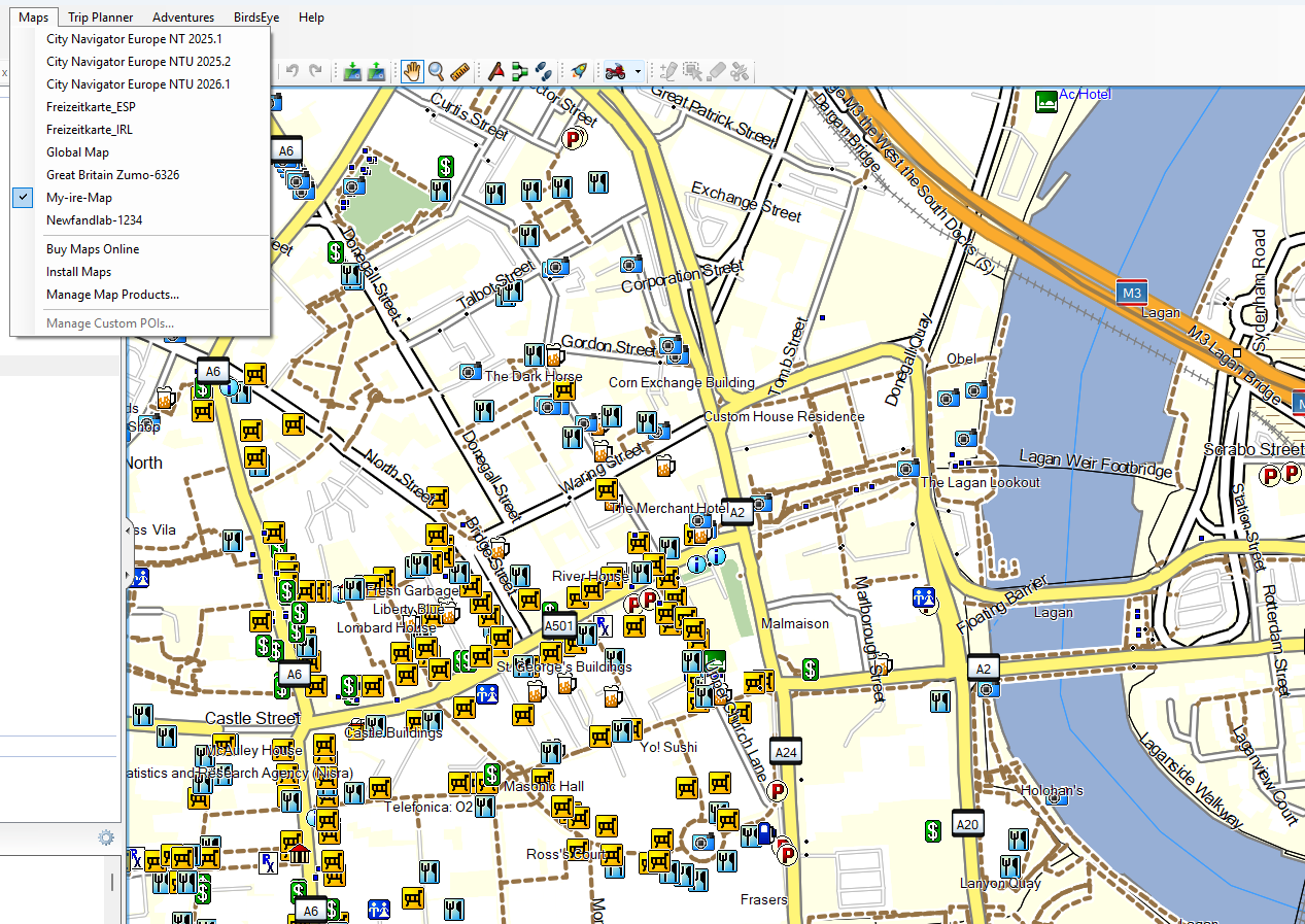

The final map is a map of Ireland I created using the command line which is generic and tested on a Streetpilot 2610, Nav IV, Zumo 390 and ZumoXT
the map is of Belfast city centre.
Screenshot 2025-04-13 202121.png (758.64 KiB) Viewed 6077 times
