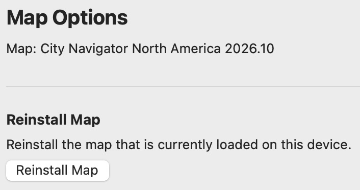

danham wrote: Mon Apr 07, 2025 1:03 pm OK, now I understand the problem and per usual, sussamb is correct. Have you tried using Express, Map Details, Options to re-install 2026.10 without first deleting any files? That option is offered on my Mac using Express 7.25.0.0. That is the safest option.

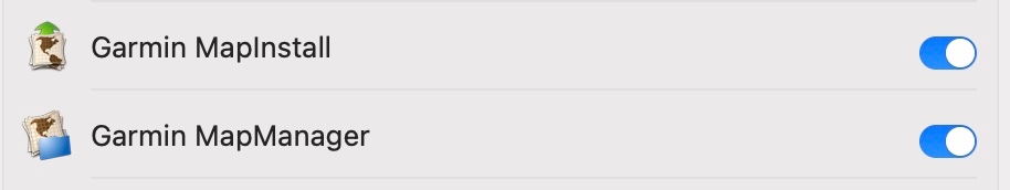

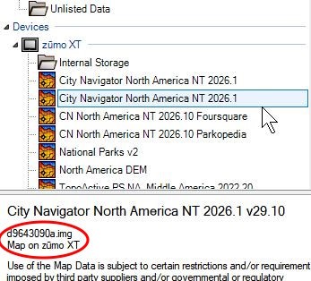

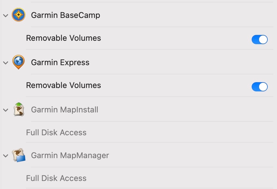

Yes, the first thing I did was update Express which is v6.60 on my MacBook Pro. As for BC, I'm on the latest v4.8.13. I then proceeded to update to 2026.1 While going through the steps, I received a pop up stating that it couldn't download. I then checked my Privacy & Security settings > Full Disc Access & Files & Folders. All was turned on as shown below. I then tried once again downloading v2026.1 in which it still wouldn't. I then proceeded looked around in Express to see if I could re-install. I was able to do so.... Now I have all three on the XT showing up on my Map list as shown in the OP.

You can manually delete the maps by activating access to the .System folder, where the maps are stored in \zūmo XT\Internal Storage\.System\Map. The file names are not descriptive (D#######A.img), so use Basecamp to identify the correct file names to delete:

Quit ALL programs, especially Basecamp, and connect your XT. Wait for it to go into Connect mode, which can take a while. Launch Express. Go to the Map Details, Options menu to re-install the latest map.

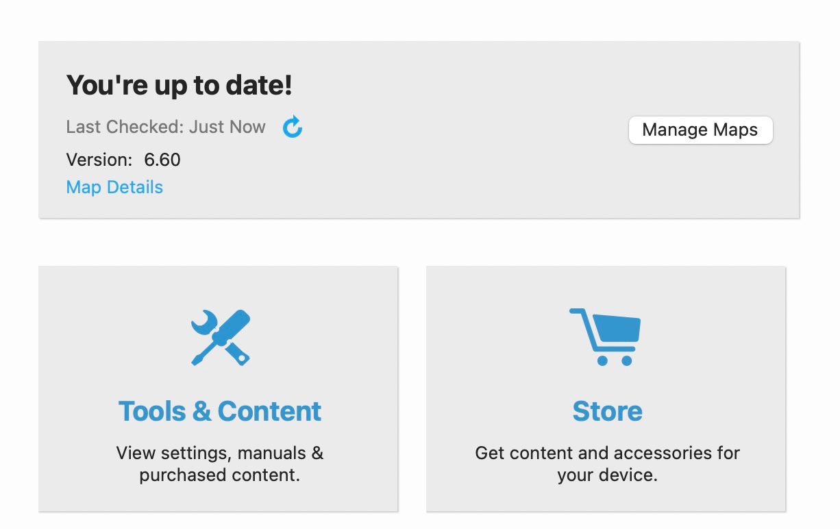

danham wrote: Mon Apr 07, 2025 4:16 pm I'm still a little confused about what exact steps you are taking, so let me try to briefly summarize what SHOULD work...
Express for Mac is now at version 7.25.0.0. Is that the one you have?
No, Garmin Express shows I'm up to date on my Mac with 6.60;
V 6.60.jpeg (87.29 KiB) Viewed 3433 times

Why is Express claiming version 6 is up to date? Is your Macbook really old? What model is it and what version of Mac OS are you running? I have a 2017 iMac running OS 13.7.5 (Ventura) and it calls for Express 7.25.0.0.
I'm pretty sure that the map "versions" you are seeing are in fact aborted/corrupted files created during the download attempts. You may need to get rid of them and do a fresh install, but if you can resolve the out of date Express issue I'd still try another re-install first to see if it cleans up the mess automatically.

danham wrote: Mon Apr 07, 2025 5:06 pm As I gain understanding of your situation, more questions. Sorry to keep hitting you with them, but such is the nature of diagnosis from way out in the cheap seats.
Good Question
