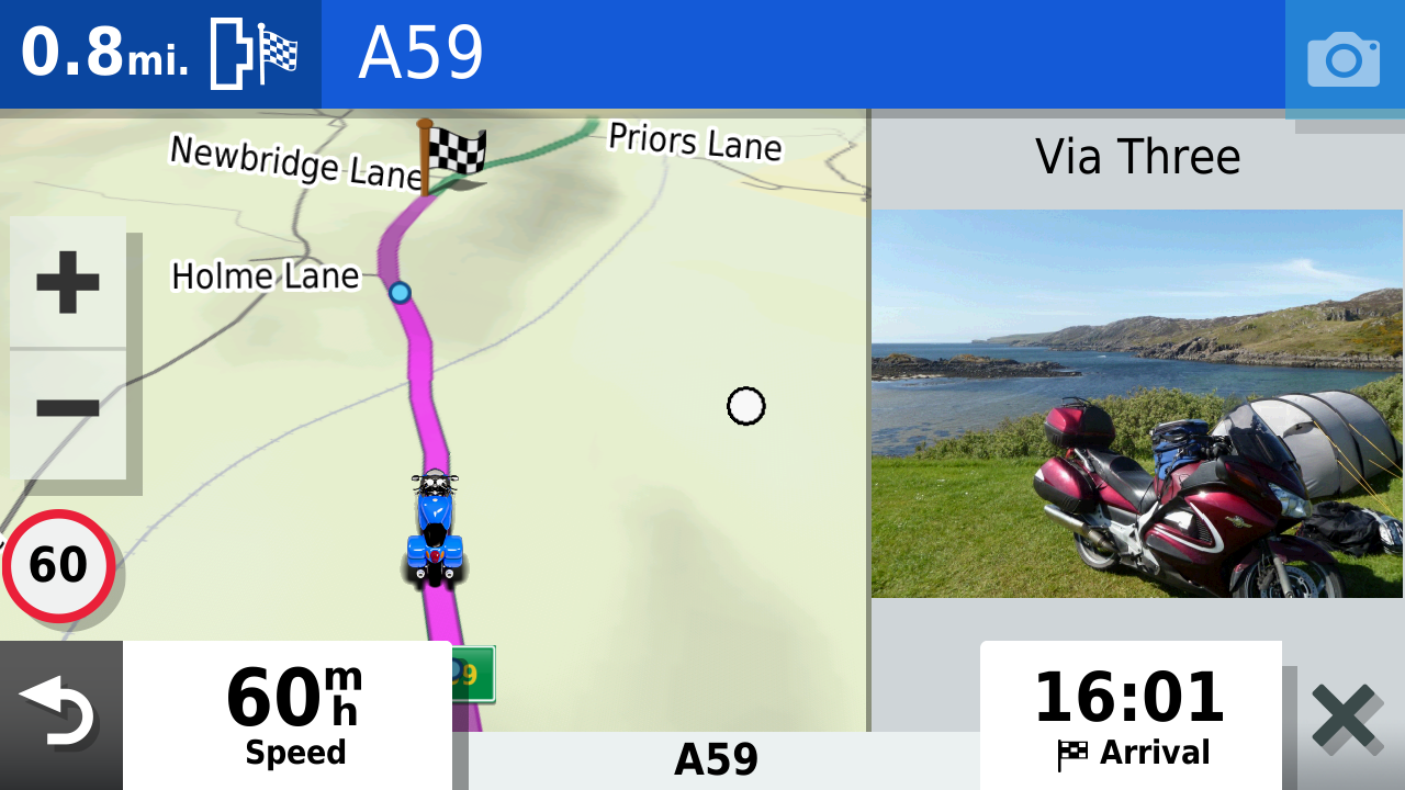

10TourGuide Alert.png (564.53 KiB) Viewed 17984 times

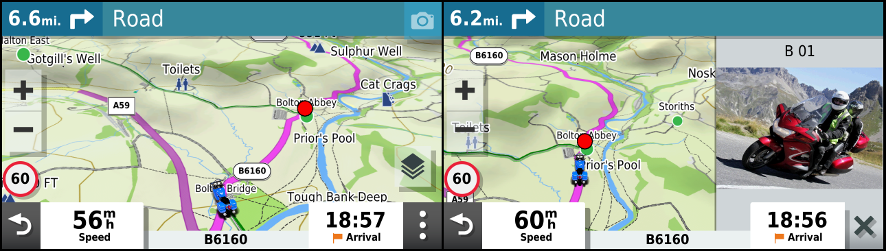

In the above screen shot, a POI is identified by a large white disk - about 300m from the road that I am traveling. In this case the proximty value is set at 0.4 miles. As soon as I get within 0.4m from any direction, the sound plays on the Zumos MP3 player, and the picture pops up on the screen.
This is not because I am traveling along a route, or because I am approaching the blue disc shaping point, or the finish point. It is because I have just passed throught the 0.4 mile circular perimeter that I set for the white disc.
In this case I am using the XT at my desk - in order to move the bike, I need the bike to be moving, so I am simulating this using a route.
It is a facility that is made available for companies that offer guided tours of eg stately gardens. You are free to wander around at will, but when you get to a particular point - you get the photo and a narrative. Or when you are within 100m of a particular point, you get an indication that there is something of interest and some instructions on how to get there.
Whatever narrative you choose, you have to remember that this thing is triggered regardless of the direction of travel. So giving instructions like 'Turn left' are not helpful. 'Head north' is better, but it relies on the user knowing where north is.

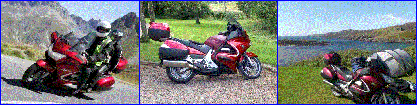

For this demo, I just found 3 images of motorbike. The website has reduced these images - click on them to see the full size version. Each of the three images is 480 x 360

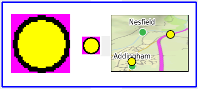

The picture below shows the 24 x 24 image. On the left, I have enlarged it to make the idividual pixels very clear. The smaller version is what it looks like in the editor actual size. On the right is how the same icon appears on the XT screen.
Note that in the demo, I have used 36x36 bitmap images for the icons. They seem to work OK with the Zumo XT - but the documentation was written a long time before the XT came out. If you are trying this on anything earlier than XT, there may be issues.
Image Compare.png (30.19 KiB) Viewed 17979 times
The magenta colour (RGB = 255,0,255) will be regarded by the XT as transparent. All you will see is the black and the yellow - the magenta will not be seen and anything that is behind it will be seen.

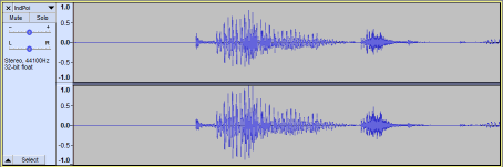

Create a 'Ping' ... alert sound
This can be any mp3 file. It needs to be reasonably loud and could be a simple ping sound or a voice recording, or a complete piece of music. Up to you. Audacity is a free piece of software that allows you to edit and create MP3 files. Google it. It's free. It is brilliant.
Find or make a sound and store it in the folder for the Waypoint/POI. I created one with me saying 'Point One'.
Save this as (eg) J:\TG-Demo\TourGuide-01\TourGuide-01.mp3

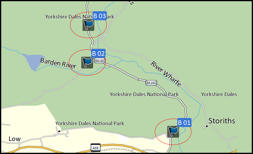

  1. Create all of the waypoints in Basecamp using the waypoint flag tool
  2. Name each Waypoint whatever you want - but it will help if you include the number that you used in the folder name. Eg 23 Camp Site or Camp Site 23 - That will help you in error-checking. You can remove the numbers later if you wish.

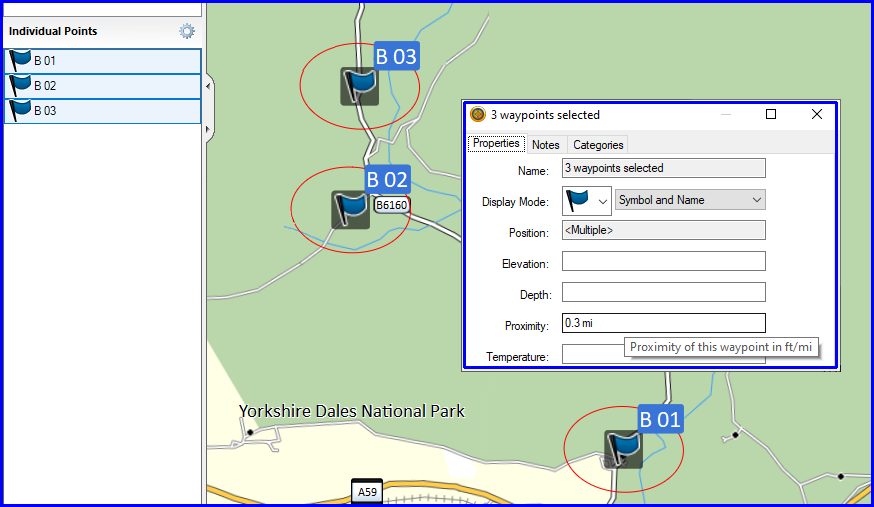

  3. You need to set a Proximity / Perimeter alert for each POI. This can be anything up to 24901 miles. You can multiselect Waypoints, right click to select Open, and enter a value. This will set the same proximity for all of the selected Waypoints.

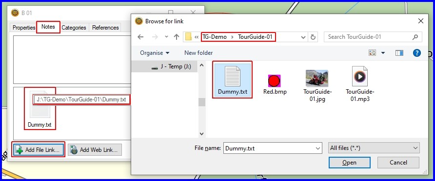

If Using Option 1. (Individual Points)

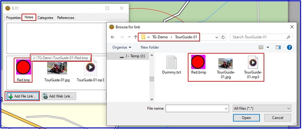

  1. For each Waypoint / POI - In BaseCamp
  2. Click the Notes tab at the top of the dialog box
  3. Click "Add File Link"
  4. Navigate to the folder where the icon, sound and image files are stored. Make sure that it it the folder for this Waypoint. This is where it is handy to have the same number for each BC Waypoint, each sub-folder, and each image and sound file within that folder.
    So in the example image below, I am looking at Waypoint B 01. I navigate to folder J:\TG-Demo\TourGuide-01\and I add each link in turns TourGuide-01.jpg, TourGuide-01.mp3, Red.bmp
  5. Optionally you can add notes - these are dispalyed in the information button when looking at POIs on the XT screen. Unfortunately it displays the text twice - once as a comment, once as a description. I don't know why, and I don't have an answer.
  6. Do the same for every other Waypoint.
  7. My screen image shows Dummy.txt. If using Option 1, you do not need Dummy.txt.
13 Notes Link Option 1 .jpg (69.79 KiB) Viewed 17975 times

Please note that the proximity setting for a Basecamp Waypoint is determined by the value for the Measurement System that is set in Edit -> Options -> Display. Mine is set to Statute (miles and feet). Decimal miles are accepted in the proximity field.

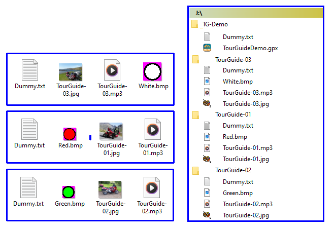

We should now have a folder, close to the root, called TG-Demo. (eg J:\TG-Demo)
In there we should have a single GPX file which contain all of the Waypoints that we have prepared. In my image below, the right hand folder tree shows this file as TourGudieDemo.gpx
Also in the folder there should be a number of sub-folders - one that is associated with each POI / Waypoint - These are called TourGuide-01, TourGuide-02, TourGuide-03
In each Sub folder 3 files - for an icon, a sound and a picture. The sound and picture must have the same name, and must contain the word 'TourGuide'.
14 FIles for POI Loader.png (58 KiB) Viewed 17972 times

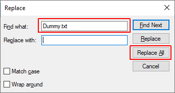

If you linked to Dummy.txt, then Edit the GPX file.
This process is not necessary if you linked to each icon, image and sound waves for every Waypoint / POI
If you just added a link for Dummy.txt, we need to change them. That is much easier than it sounds - it is one operation:
Open the GPX file in a simple text editor - like Notepad.
About 35 lines down (it will vary between users), there is a line that says something like
  • <link href="J:/TG-Demo/TourGuide-02/Dummy.txt" />
There will be one line for every Waypoint that you created. We need to change those lines to read :
  • <link href="J:/TG-Demo/TourGuide-02/" />
ie - we need to delete the text 'Dummy.txt'.
Move the cursor back to the top line of the file and then select Edit -> Replace
- you should get a dialog box like the one shown below.
Replace Dummy.png (7.53 KiB) Viewed 17972 times
Type Dummy.txt for the text to replace, and make sure the other text box is empty.
Click Replace all. You can check if you wish that these lines have all been altered.
Then click 'Save'

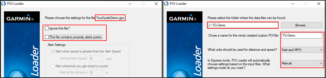

Run POILoader

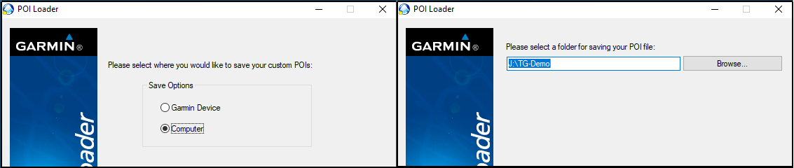

When you run POILoader, it will want to know :
  • The folder where you wish to save the POI file. (eg J:\TG-Demo\)
  • The name of the gpx file containing the Waypoints (eg TourGuideDemo.gpx)
  • The location of the data files - gpx file. (eg J:\TG-Demo\)
It will find all of the GPX files that are in that folder, and for each, it will ask if you want the gpx file to be processed.
In this example, there is only one GPX file - TourGuideDemo.gpx - so the question seems a little odd. But if it spots other gpx files, it will ask if you want to process them as well - one after the other. You need to read carefully what POILOader is asking, and make sure that you accept the one(s) that you wish to process.
POI Loader will use the GPX file to identify the route points. Each route point has a proximity / perimeter value.
It knows where the icon, image and sound files are - due to the links that you placed in the notes tab.
If you only placed the Dummy.txt file, we edited the gpx file to point to its location. It searches the entire folder for any relevant files.

To test that these POIs work, I am going to set a simulated route that travels the road near to which I placed my POIs, and take some screen shots when each alert is triggered by me entering the circle.
POI Map in BC.png (109.14 KiB) Viewed 17971 times
So I will simulate travelling north from the A59 along the B6160. Point 2 is located to the left of the road, but my route will still pass through its perimeter circle - so it should alerts.
Here are three images of the simulated trip, having entered the proximity circle each time.
There is no information displayed on the banner, but the picture pops up with the name of the POI.
In the notes section, it is possible to write some text - which also pops up - but it does so twice - because the gpx file contains the text as 'information' and as a 'description'. Oops. This was tested on an XT.
You will have to take my word for the fact that the sound file was played as the image popped up, and with perimeter set at 0.3 miles, but it did. The sound file was played just once.
The first picture shows me about to start my simulated ride north on the B6160. Already in the left screen shot, B01 is in view - the large red circle - although I have not yet got close enough to trigger the alert. Ignore the arrival times - they are for the final point on my simulated route. Interesting that in simulation the bike is traveling faster than it calculates. ETA is going down...
The right hand image shows the image for B01 pop up as I get close to the red icon - and the sound file plays. Me saying simply 'Point One'.
15 Test Ride 01.png (518.46 KiB) Viewed 17971 times

I tried to load the TourGuide POIs into my Zümo using TripManager, Unfortunately, this did not work. TripManager generated ordinary POIs, but not TourGuide POIs. TripManager does not yet support the import of TourGuide POIs
In the meantime, you have to use POI Loader, hoping that Garmin does not abandon it (I have the impression that they prefer very basic users).
