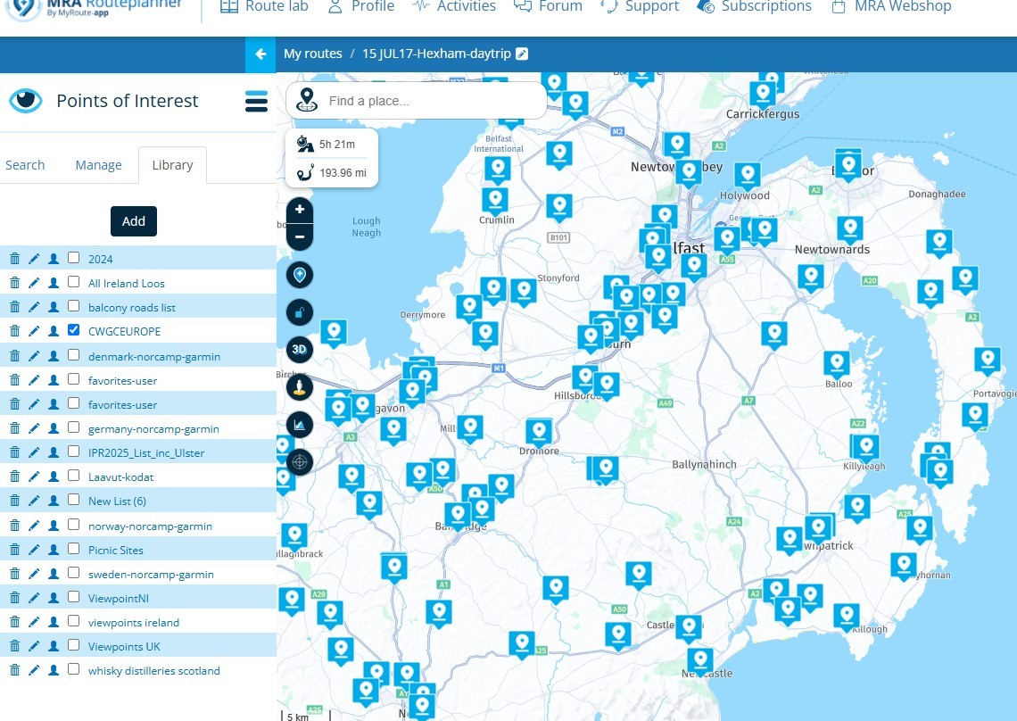

MRA is not as good at handling POI's as basecamp. However, you can create a library of your own POI's
Screenshot 2025-03-18 110515.jpg (238.12 KiB) Viewed 3909 times
This is a list of my POI's above with Commonwealth War Graves highlighted. If you click on a route and turn on the POI's they appear beside your route as you ride along and you can make your POI's a waypoint on your route. This is how it works on the native app.
If you import a route with POI's highlighted into the XT (i usually use Garmin Drive) then the poi's go into favourites which is a pain if you have a large database like the one above. Better when planning the route to include the POI's you want to visit as waypoints/via points within the route (which you can do by right clicking on them) and then only the ones you select will go into favourites if you then turn off the POI layer. Obviously things like proximity warnings that you can set with garmins own POI loader are not available to you. I have one set of POI's for this purpose through POI loader (All Ireland Loos) at the top of the list and have a warning (visual and audible) set on my XT so that when I get within 1/3 mile of a public loo it flashes at the top of the screen (and makes a fart noise becasue I have the intellect of a 9 year old)
