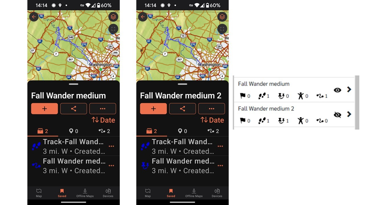

In the pics below, Fall Wander Medium was pulled in via Explore app. Fall Wander Medium 2 was pulled in via Tread. Views how each shows in Explore app and in Explore browser.
