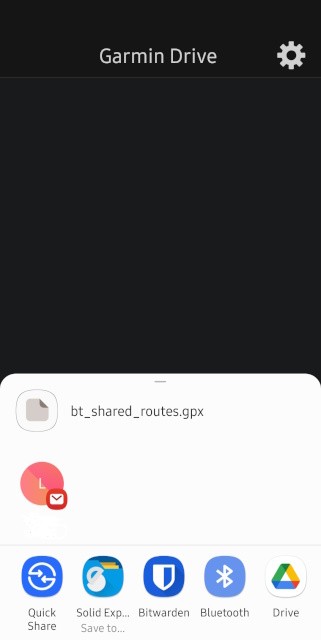

I just now tried this for the first time, out of curiosity. I shared a route from the Trip Planner, with Drive already open on my Android phone. My phone screen showed
first time.jpg (25.14 KiB) Viewed 4533 times
Tapping Share, I had a choice of several apps to share the file with:
I picked Solid Explorer, my file manager, where I was able to browse to a destination folder, and then the route was available as "bt_shared_routes.gpx". It imported easily into Locus.

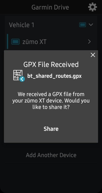

Well, I tried sharing from the XT with Garmin Drive open on my phone and in the foreground, and nothing happened at all!
So I closed the app completely and I shared a route/trip from the XT. This time the banner advising “GPX File received from zumo … Tap here to save or share the file” came up on the phone as before, and as before, when I tapped it, Garmin Drive opens but there’s no sign of the GPX file.
I suspect this is a “Trip Options” feature on the XT which isn’t actually available.
Re: Can I share trips/routes from the XT to my phone?
I just tried this on my iPhone. I get the Garmin Drive notice on my iPhone saying that the route has been received and at the bottom of that is the word 'Share'. Tapping that brings up a number of options like AirDrop, Messages, Mail, and a number of other Apps but also Copy, New Quick Note, and Save to Files. I selected Save to Files which then prompted me to specify where in my iPhone files I wanted to save it, allowing me to assign a meaningful name to the file (default is "bt_shared_routes.gpx"). I did this twice, with two different routes. I was then able to open both in the GPX Viewer app as well as Share them via the normal methods (AirDrop, Text, EMail, etc.). Unfortunately this doesn't help Android phone owners.
