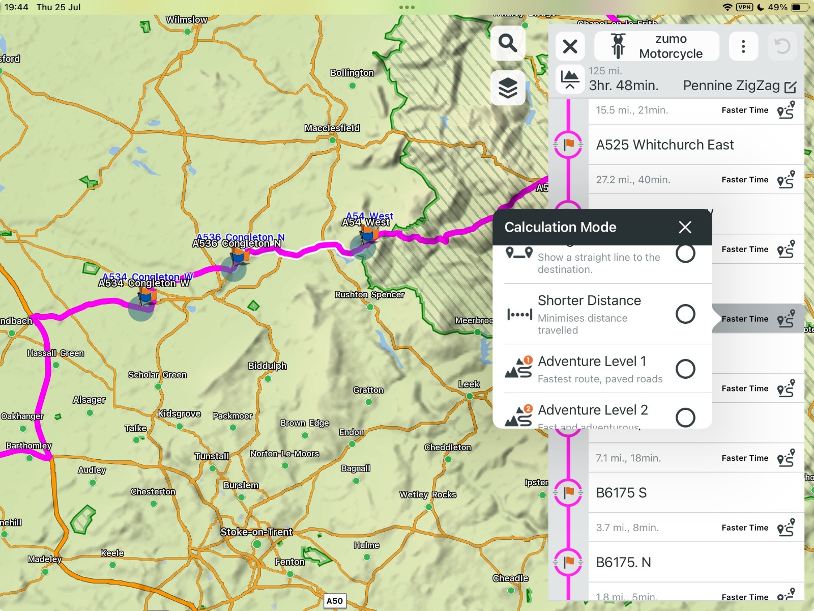

Take a look at the screen shot of my Ipad taken from the route that I planned in a hotel room on Tuesday night. Click the image for a better view.
Tread Route on Ipad.jpeg (410.41 KiB) Viewed 1404 times
You can see that I have a number of Via Points (orange flags). You can also see that there is a little blue flag as well - in the same place. This is because before creating the route, I zoomed in and created a few waypoints first. (Remember that a Waypoint is a saved location, it is not a point on a route as many people believe).

I am not going to dwell on that (yet) becasue on my screen shot, I have tapped aprt of the map where the route is. The bit between A536 Congletone N and A54 West. I got a pop up asking me what I was pointing at, and one option was 'Select this segment'. For Tread a new term 'Segement' has been defined. It is the bit of route that lies between two Via Points - (or stops as they now seem to be named). That segment is highlighted with a white outline. Very pretty. Frills.
Note that the route list has a line between each pair of Via Points - with some distance and timing information - but also 'FAster Time'. You can change the route preferecne for each segment. You could never do this with Basecamp. The options are Faster, Straight, Shorter and Adventurous 1,2,3,4. And it applies just to that section.
Unlike BAsecamp routes - this information is sent to the XT2 it is recognised by the XT2 and if the route is recalculated, that segement will be recalculated using the setting that it was saved with.
Overriding all of this are a few settings which apply to the whole route. Popular Paths (Moto), Michelin Scenic Roads, Hills and Curves.
You select whichever you want the route planner (and the XT2) to consider using when calculating your scenic route segement.

Finally for now. When you have a frilly segement selected, you can then point a finger somehwere on the map and get a pop up menu that allows you to add a shaping point or a stop (via) to the route - - it will adjust the frilly segement to vsiti that point.
