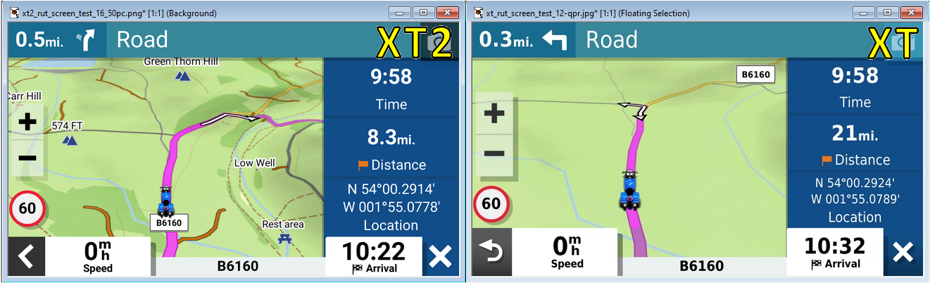

The Tests - XT routes on the left, XT2 Routes on the right.
Screen Tests.png (81.62 KiB) Viewed 3908 times

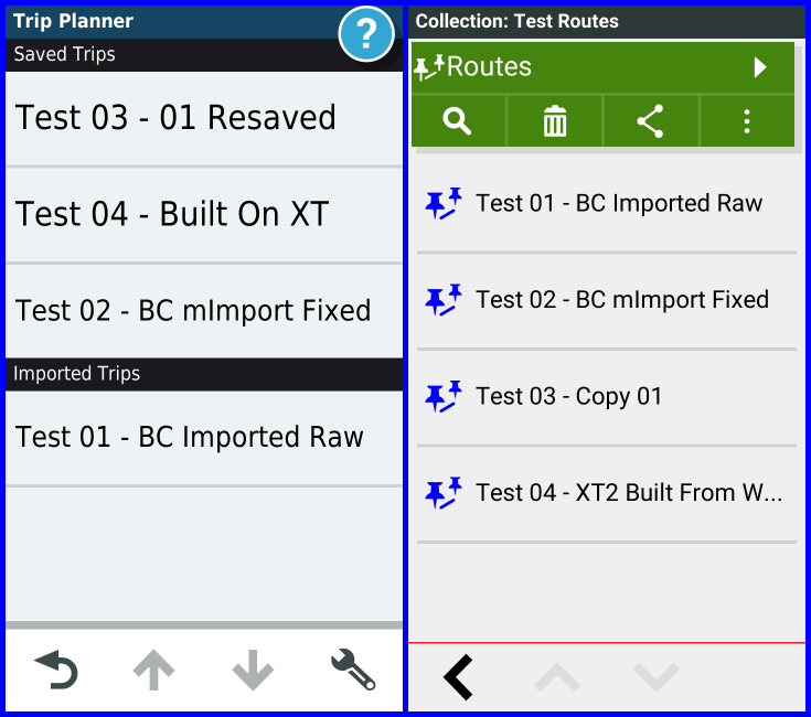

Same route installed on each device, but the route has been prepared in different ways.
  • 01 - A route exported direct from Basecamp as is. Typically this route would show RUT behaviour under the circumstances described.
  • 02 - The same route duplicated, but given a different name. This has had its mImpoted byte changed to false - so the XT thinks it has been saved, rather than imported.
  • 03 - Test 01 route has been loaded and resaved on the XT, and simply copied on the XT2. In both cases it has been given a new name. The suggestion is that the Zumo thinks that these routes are not imported, and will treat them differently.
  • 04 - All of the via points were created as Waypoints. This makes it possible to create a route using the Zumo screen using the identical route points. So this will be test 04.
The tipping point is about 3 miles after the roundabout where the two routes split.

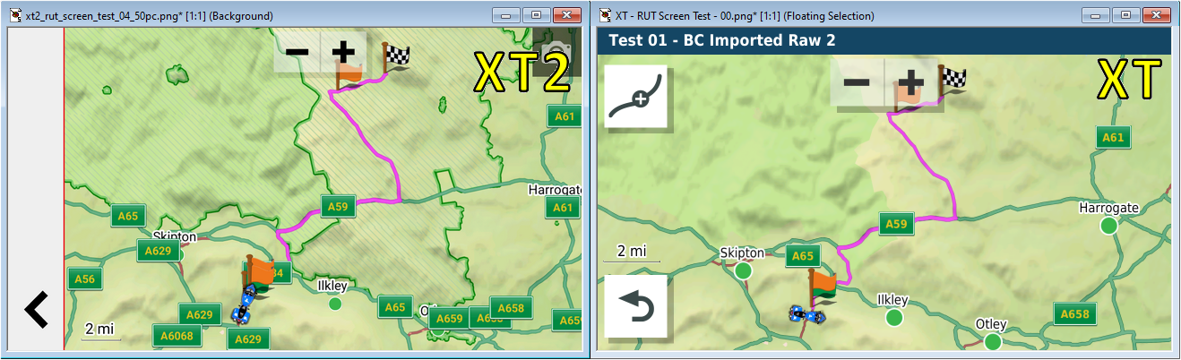

A comparison between XT and XT2 when trying to provoke RUT behaviour.
I can provoke RUT behaviour in the XT by preparing a route which has just two alternative ways to get from one point to the next. The Zumo calculates one route, I take the other. But first I have to start the route, pass through the start and then Skip a route point to force the Zumo to recalculate the entire route. The sort of situation that I have come across many times when road works, traffic, accidents etc require me to change my plans. So for this test, I put an additional route point half a mile after the start - just so that I can skip it.
Click the images to see a full size version.
Image 1. Just started route. Note that bottom centre there is a green flag and two orange flags. The green flag is my location.
The first orange flag is the start of the route.
The second orange flag is a via point that I intend to Skip.
The only other plotted points on the route are the last orange flag via point and the finish flag.
XT2 vs XT Routing 01.png (719.14 KiB) Viewed 3726 times
Conclusion - Both routes are the same at this point.

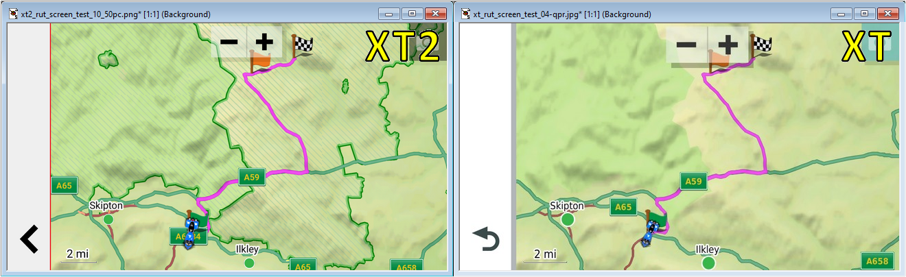

Image 2. 2 miles. I passed through the start point, and I stopped briefly to press the Skip button. This is about half a mile later - I stopped in a lyby after the skipped point to see what had happened to the routes on both devices.
Note that in both cases, the orange via point flags have gone. There is no magenta route behind me. The green flag marks my current position.
Up ahead the route is still heading East (ish) along the A59 before truning north. The orange Via point and chequered flag are both in place.
XT2 vs XT Routing 02.png (730.3 KiB) Viewed 3725 times
Conclusion - Both routes appear to be the the same at this point.

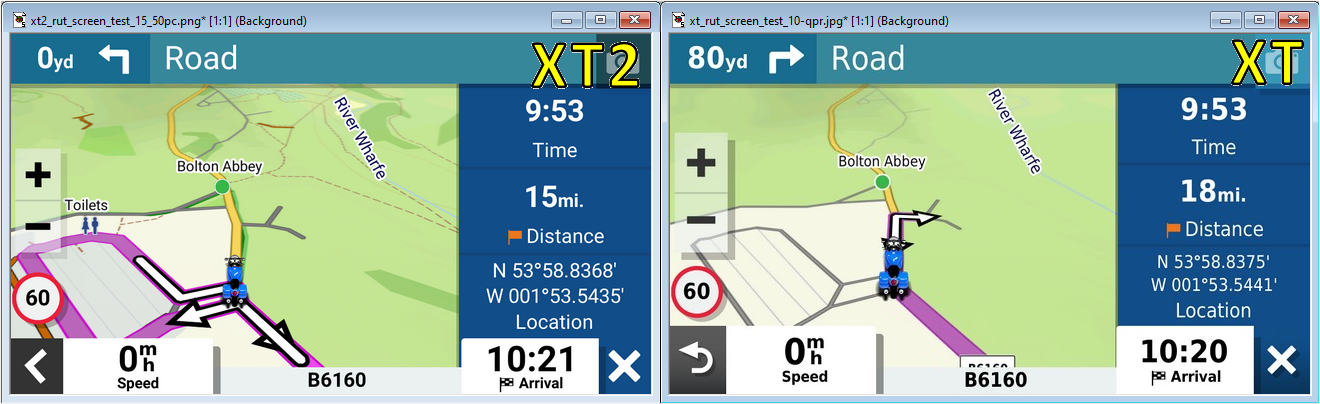

Image 3. 9:49am. Approaching A59 Roundabout
This is about 3 miles later, approaching the A59 roundabout. Curious that with identical routes and identical maps, on sat nav thinks that the next Via Point is 2 miles further away than the other. Both had recalculated the route after I had pressed Skip. Perhaps one has calculated a slightly different route from the other. If so, I didn't see it - but that remains a question mark - I will take a look at the distances on the simulator.
One of the screen shots is taken slightly later than the other - but that is of no consequence. The significance of the roundabout is that I am not going to follow the instructiosn. I am taking the 2nd exit - the yellow road heading towards Bolton Abbey.
XT2 vs XT Routing 03.png (515.97 KiB) Viewed 3719 times
Conclusion: There is a slight difference in time to be investigated, but I expect both Zumos to compain when I do not take the third exit.

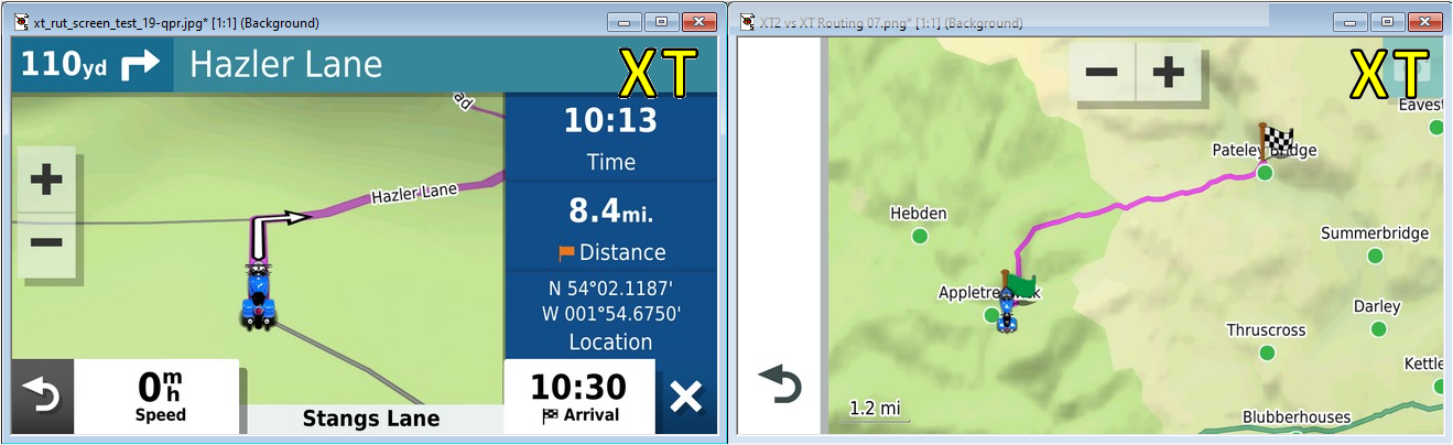

Image 4. 9:53am Turn Back Loops and U turns.
These are to be expected. The point where it is faster to continue ahead - identified by repeatedly moving the bike's current position and asking it to navigate to the end point - is a few miles further ahead. The XT2 seems to prefer turn-round loops initially, but it later demanded U turns.
The XT - well - - I messed up. I had reset the XT and forgot to check the U turn status - so that too found loop back routes or side roads. Later, I switched the XT to allow U turns. More later. Never mind - this is about the XT2, and what that does when it reaches the tipping point.
Note that the distances to the last Via point are both increasing - because the Zumos are expecting me to go back to the roundabout.
XT2 vs XT Routing 04.png (458.16 KiB) Viewed 3718 times
Conclusion - U turns / loop backs are expected behaviour on this section of the road. Both Zumos are beahving normally.

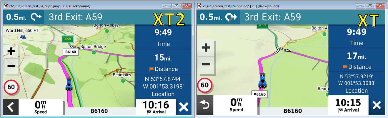

Image 5. Approaching the Tipping Point - 5 minutes later - where it is faster to go ahead, than it is to go back.
Half a mile before the junction, the XT2 has already identified that it can take the road I am traveling and get there faster than if it turns me back.
Look at the arrival times shown in the images for the last screens.
At the same point, the XT is still trying to turn me back by using the road on the left.
XT2 vs XT Routing 05.png (495.5 KiB) Viewed 3716 times

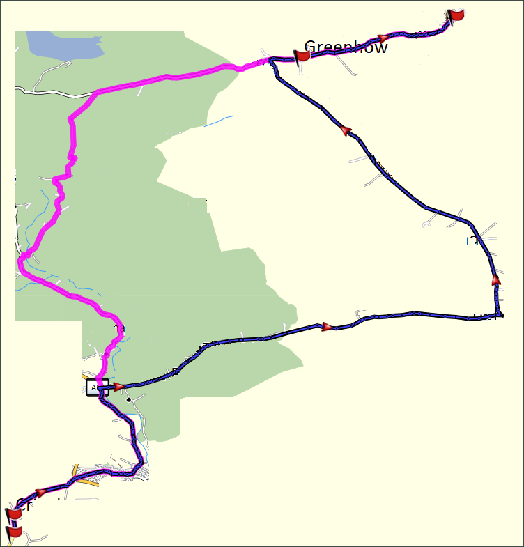

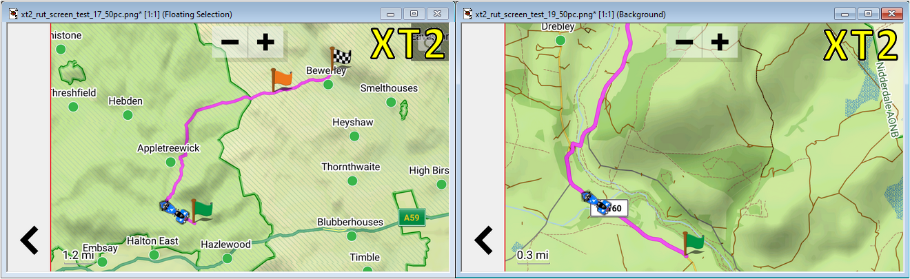

Image 6. The Remainder of the XT2 route on the preview map.
Both images are the same location. I zoomed in and took the right hand image because I noticed something different: The position of the green flag. ie the start of the current section of the route - after it had recalculated. Note also that the orange Via point and the end point are still in position. This is exactly what I believe should be happening - at each point, before deamnding a U turn to pick up its last calcaluated section of route to go back - it should calculate the distance or time to the next route point (via or shaping). If it is less than its previous calculation then yes - let's go this way please.
XT2 vs XT Routing 06.png (806.08 KiB) Viewed 3714 times

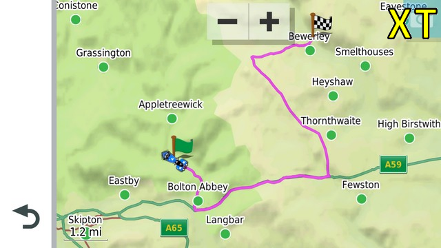

Image 7. XT Overview Map at the same location.
This is the XT screen, 2.5 miles after the point where the XT2 decided to route ahead.
XT2 vs XT Routing 07.png (312.98 KiB) Viewed 3709 times
Conclusion: Positive outcome for XT2 - But not yet Proved.
