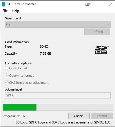

I hate to "give in" and let hardware "get the best of me" so I tried all day to format that stupid SD card. No matter what I tried, it always came back to having "1.46 GB free of 7.34 GB." It's as if it is write protected. I even tried to format it as NTFS which supposedly worked and showed the entire 8 GB available, but then I reformated it Fat32 and it went back to the original 1.46 GB free. I even put it back in my phone and tried to format it there, to no avail. So I guess I will finally admit defeat and await the new one on Tuesday. Hopefully, the Zumo will detect it.
Edit: As one last resort, I am trying this: https://www.sdcard.org/downloads/formatter_4/index.html

Re: 660 issue while updating - SD card related
Frigging piece of $#!&! Rassen-frassen double blassen....
It wins...
It wins...
