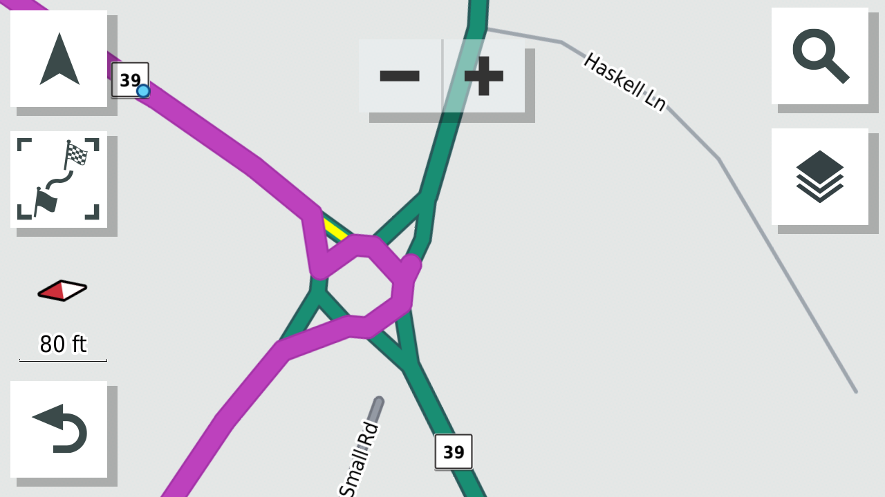

I have a relatively short local route that is driving me nuts. It was created many versions of maps and GPS models ago, so I knew I would have to recalculate it using the latest CN NA NT and once imported to Trip Planner, "fix" it using the JaVaWa tool. It displays just fine in Basecamp, with no U-Turns or other weirdness.
But once it is activated in the XT, from reading the directions (I haven't ridden it yet) it sends me part way around a roundabout, tells me to take the 2nd exit, do an immediate U-turn, re-enter the roundabout, then take the next exit (which is the correct one, as shown by the stripe in BC).
Later in the route, it has me go straight down a road, do a U-Turn, then immediately another one, and keep going in the original direction.
I have tried all sorts of fixes (recalcs, shaping points, rename route), with no luck. My next move will be to create the route from scratch in BC.
Here's the roundabout as shown in the XT. Direction of travel is from lower left to roundabout. Purple stripe has two weird jogs in it; yellow is the track showing correct path onto Rt 39.
Your thoughts?

I wouldn't fight to try to figure out the roundabout routing problem. Instead I would put a route point at the 3:00 position on the roundabout and make it a Direct point. That should give you a straight line to the next route point which I believe I see in the image as a shaping point at the upper rte 39 marker.
Note: There is something unintuitive about setting a point as a Direct point that I don't specifically remember but it has something to do with which point gets set as Direct, the first one or the second one. You may have to play with this.
As for the other weird u-turn issue, that is classic behavior when a route point is positioned on the wrong side of the road. You can try repositioning it or delete it and add a new one to see if that solves it.

In your roundabout, there is some weird routing going on - it looks like the traffic flow is the wrong way round on the exit at the 10 o clock position. I'd say mapping error.

"In your roundabout, there is some weird routing going on - it looks like the traffic flow is the wrong way round on the exit at the 10 o clock position. I'd say mapping error."
That's what I think as well. The purple stripe would have me riding into oncoming traffic. People here are dumb enough about roundabouts without adding that factor. ;-)
