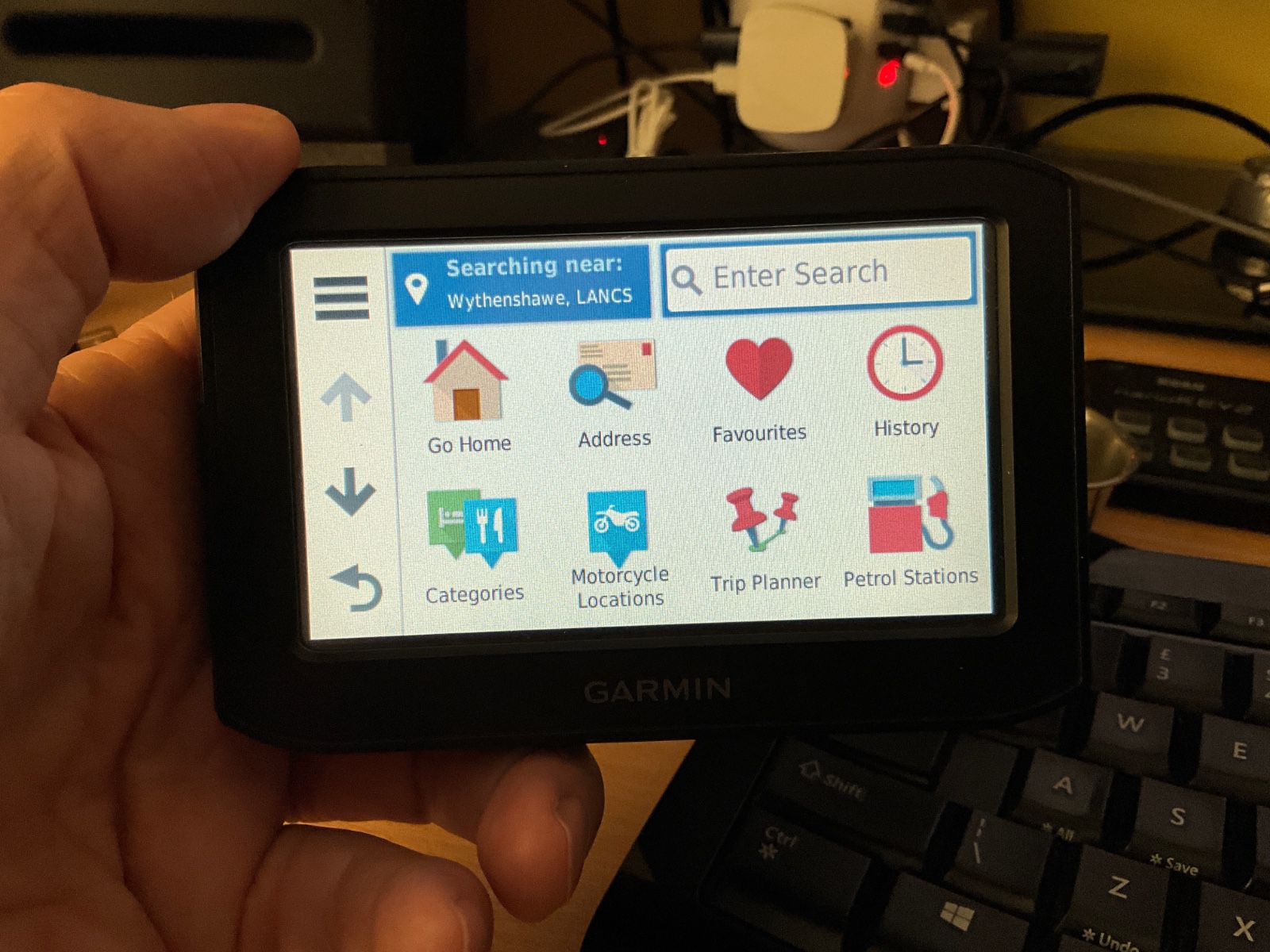

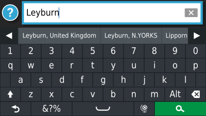

Re: 396 recognises UK destination, then sends me to France!
Aha.Beery1 wrote: Thu Apr 04, 2024 11:14 am Then i clicked > where to > trip planner > new trip > + add location (no start location) entered ‘leyburn’ as 2nd location (first location i clicked a point on the map) - it found ‘leyburn, n.yorks’ so i clicked on that and it brought up a list of locations… none of which were leyburn in n.yorks!
Now - remember I don't have the 396. But my 590, 595 and XT all do the same thing - in slightly different ways. The 396 came out between the 595 and the XT.
I select Apps->Trip Planner etc.
Now I remember it took me ages to spot this particular feature. But as you type in L --- E --- Y ---- B etc there is a scroll bar displayed above the keyboard which displays likely candidates. This form the XT - I had to scroll left/right with the pointers. I then selected Leyburn, N. Yorks from that banner. It found the correct one, and kept the correct one.
If I select the green magnifying glass, bottom right, then the Zumo searches its database for whatever you typed. I don't know, but this seems to be getting the data from elsewhere. FourSquare is the database used on the XT and that seems to cause all sorts of issues at different times for different people. But if you scroll across the alternatives, and choose Leyburn, N.Yorks from that by tapping the word on the scroll bar - that seems to behave much better.
In the above, note the little tear drop icon to the left of the white banner. This is another button that is hiding in plain sight. It presents itself in different forms on different Zumos, but it is still there. On one of mine it is accompanied by the caption 'Searchin Near'.
And that is exactly what it does. It tells the Zumo where it has to search for whatever you are typing in.
Options are to search near to:
My Active Route
My Destination
Upcoming Exits
Where I am Now
A different town
A Post code
A recent destination
A favourite
Give that button a tap, see if you can get it to produce a better list.
Thanks lots. So i tried a v simple search this time. Clicked the ‘where to?’ Icon, then entered Leyburn straight into the white search box on next screen (hopefully the image attachment works!) It then finds the place as i’m typing so i select the correct place ‘leyburn, n.yorks’…jfheath wrote: Thu Apr 04, 2024 1:37 pmAha.Beery1 wrote: Thu Apr 04, 2024 11:14 am Then i clicked > where to > trip planner > new trip > + add location (no start location) entered ‘leyburn’ as 2nd location (first location i clicked a point on the map) - it found ‘leyburn, n.yorks’ so i clicked on that and it brought up a list of locations… none of which were leyburn in n.yorks!

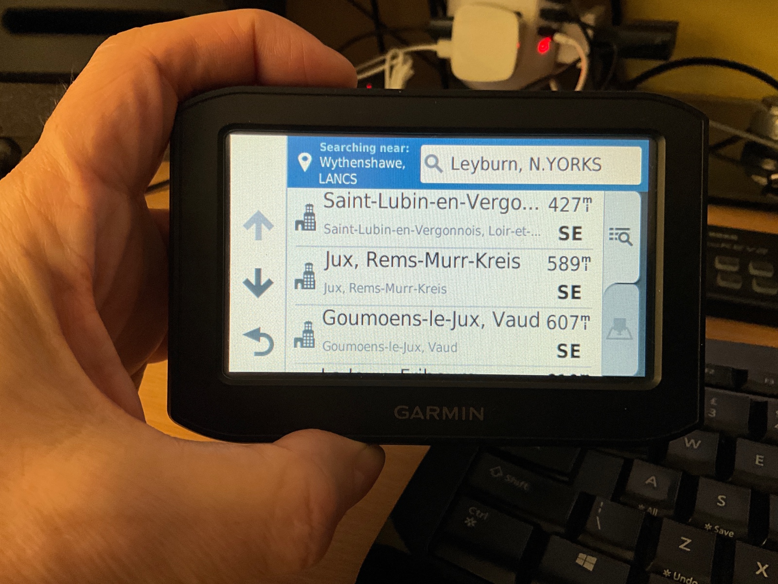

And the results are wrong… Clicking the ‘searching near’ button as you suggested doesn’t make any difference unfortunately

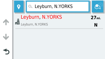

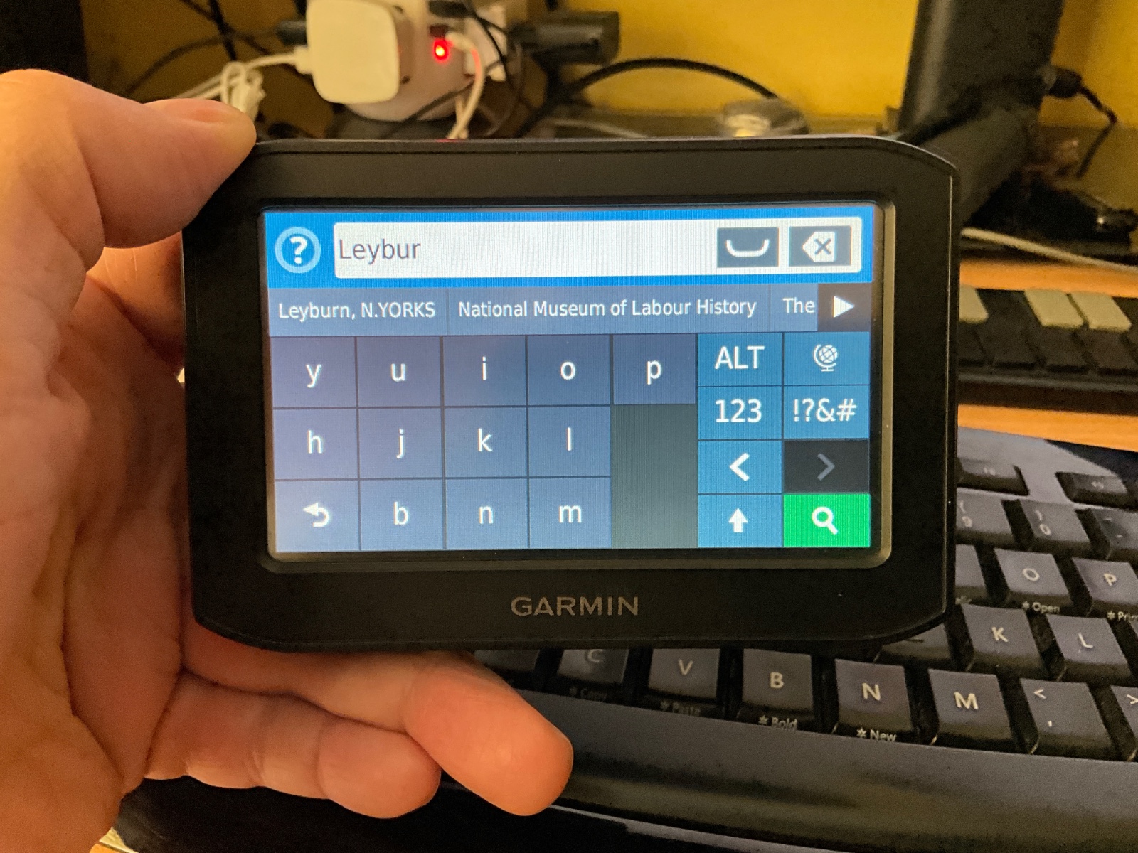

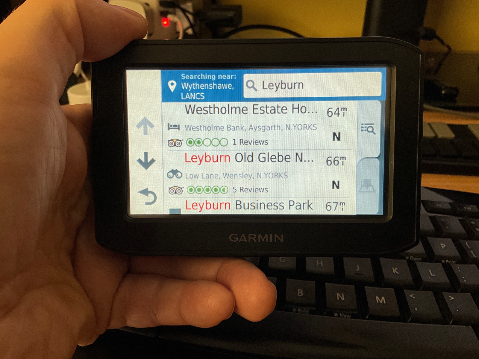

Hmmm. Just experimented with the green search button. If i type in ‘leyburn’ then don’t click on the suggested ‘leyburn, n.yorks’ option below it but click on the green/white magnifying glass button instead, it seems to display POI results around the correct leyburn - just not the town itself. Weirder and weirder…
OK thanks for trying those. So now we have found another way that doesn't work.
I wonder what makes it think that you are in France ?

Let me recap.
You search for a location eg Leyburn
You select the Leyburn N.Yorks from the banner
The Zumo gives a list which does not include Leyburn, N Yorks, but does give Leyburns in other countries.
Is that correct ?
I note the screenshots have a search criteria. Can you change that to a different location or Where You Are now, see if the behaviour changes.

As to your recap - correct except the results don’t show any leyburns at all. Just totally different named places in different countries with no apparent similarity.
